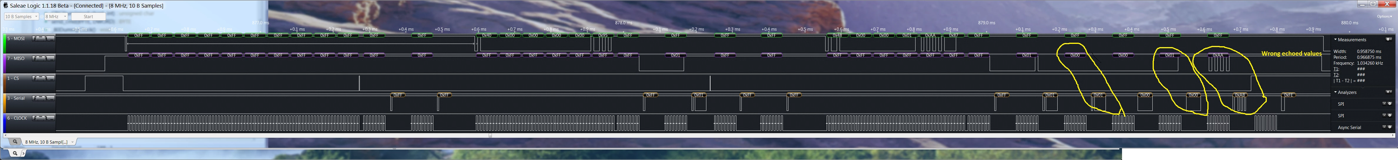

I'm porting an implementation of SD over spi to stm2 using Cube library.
It seems that the communication micro to sd card is ok, it seems that the sd card
answers like it should but it looks like the microcontroler does not interpret correctly
the data on the spi bus.
To get this conclusion, I asked the micro to echo each byte received on SPI to an uart.
On the logic analyzer screen capture joined, you can see :
- on channel 5 (green), data micro -> SD
- on channel 7 (pink), data SD -> micro
- on channel 3 (orange), the uart echo.
Each byte on channel 3 should be the same of the preceeding byte on channel 7 which is
not always the case.
Here's the initialization code of the spi channel :

    - wire miso to mosi, write a sequence of bytes (from 0 to 0xFF) over SPI. Read over SPI after each byte written, write the read value
    on uart (should get 0 to 0xFF) : The funky behaviour is reproduced and we can see a ''sequence'' +1 / -1. Capture joined. (spi3.png)
    - ported the previous code to nucleo F411, works fine...
    To create the code for any target :
    - use cubemx to configure, one SPI, one UART
    - auto generate the code
    - in main.c juste before ''while(1);'' insert :
    uint8_t i;
    for (i = 0; i < 0xFF; i++) {
    uint8_t rx, tx;
    tx = i;
    HAL_SPI_TransmitReceive(&hspi2, &tx, &rx, 1, 10);
    HAL_UART_Transmit(&huart4, &rx, 1, 50);
    That's all.
    - used the previous code but sent each byte twice shows that it is not a +1 / -1 sequence but more something looking like
    a bit not shifted. capture joined (spi4.png)

    The fault pattern appears to be that the Nth byte's LSB is taken from the (N-1)-th byte's LSB. The strange thing is that the transfer is set to MSB-first, so if the SPI would contain a plain shift register, the LSB of previous byte is followed by the MSB...
