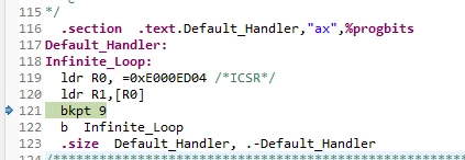

Another day, another bug....
I'm trying to use ADC3 with BDMA on H753.
Started from some cube-generated code that assigned BDMA channel 0 to ADC3.
Allocated memory in SRAM4. Added interrupt handler for BDMA_Channel0 and ADC3.
When I start the ADC3, I hit the default interrupt handler - as if the proper handler is not defined.
ICSR = 0x891 this means the active interrupt is 0x91.
0x91 - 16 = 129 which is exactly BDMA_Channel0_IRQn.
And there's the handler for it. But this handler is not hit. Why??

Pavel A.
Pavel A.Author
February 10, 2022
@Community member​
I've added some prints below.
Output:
VTOR=80E0200
intnum= 129 vec=80EA575, handler=0x80ea575
void Test_ADC3()
 printf("VTOR=%X\n", SCB->VTOR);
 printf("intnum= %u vec=%X, handler=%p\n", BDMA_Channel0_IRQn,
 ((uint32_t*)SCB->VTOR)[BDMA_Channel0_IRQn + 16],
 (void*)BDMA_Channel0_IRQHandler );
 unsigned memsize = hadc3.Init.NbrOfConversion * sizeof(uint16_t);
 f_adc_cnvrt_complete = 0;
 HAL_StatusTypeDef st = HAL_ADC_Start_DMA(&hadc3, (void*)ADC3_BUF_BASE_, memsize);
 if (0 != st ) {
 __BKPT(14);
0693W00000JPKIVQA5.pngHere it lands on the default handler, R1= 0x891

Piranha
Principal III
February 11, 2022
The 0x91 is 0b1001'0001, which after multiplication by 4 (left shift by 2) becomes 0b10'0100'0100. Now, because the current VTOR address ends with 0b10'0000'0000, after OR operation the bit #9 is effectively ignored. That means the device actually fetches an address, for which the offset is lowered by 2^9=512 bytes or 128 words. That's why instead of fetching a vector 145 (0x91) it fetches 145-128=17, which translates (by subtracting 16) to 129-128=1 for interrupt numbers.
