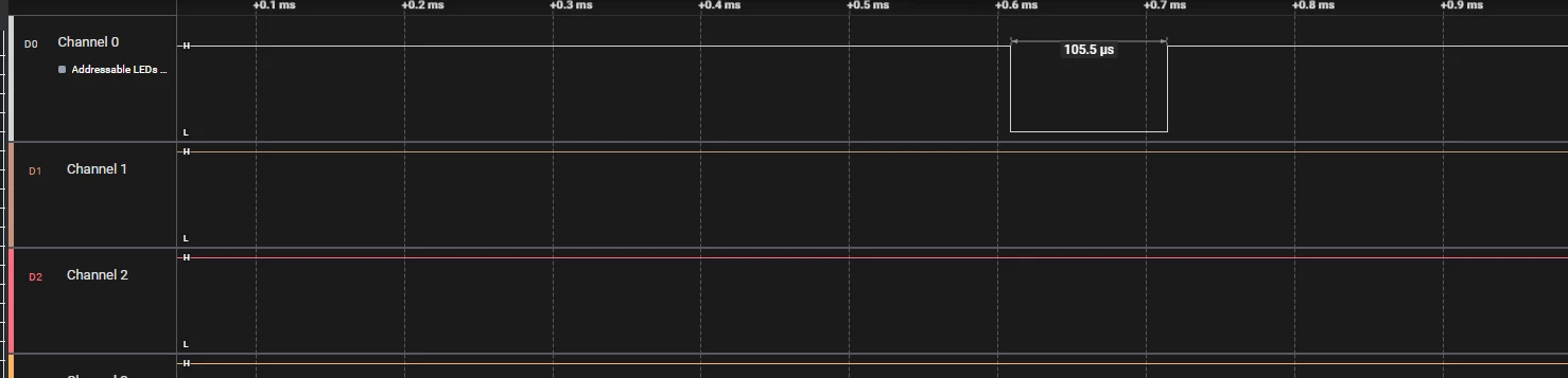

If i run the code, nothing happens, or lets say, the data doesn't get transmitted:

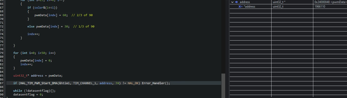

But if i look at value of the address variable in the debugger before running the ...Start_DMA...:
And then Resume the program it suddenly works:
Why does this happen?

The behavior that you're describing, where the program works after inspecting the variable in the debugger, means that there might be a timing issue or a need for a delay! This is probably related to the debug mode settings.
Try adding  a breakpoint in your callback function to monitor the execution flow and ensure that the source data has been transferred to the destination buffer

Mar 7, 2025 2:26 PM UTC
Looks like your code sets everything to 0, or at least most of it (50/74 values) but we can't see the rest. The data looks like a bunch of 0's being transmitted.
