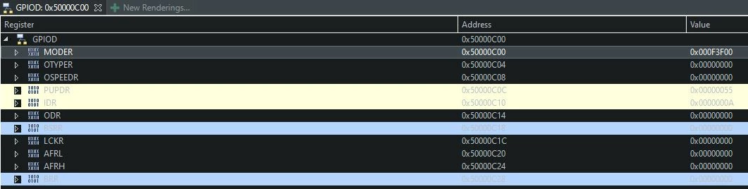

I have the GPIOD0 and 1 connected to be digital inputs (they are to be connected to open-colector device), as such i have enabled the internal pull-ups in the GPIO configuration.
The strange thing, is that only PD1 is read as '1' (or have 3.3V) when the input is "open". Even checking with the multi-meter PD1 has 3.27V and PD0 as 0V.
The pull-ups and other configuration related to GPIO seems to be OK.

LL_GPIO_Init(GPIOD, &GPIO_InitStruct);The peripheral clock is enabled for GPIOD. When seeing the RCC, GPIOD registers in the DEBUG everything seems correctly configured accordingly with the datasheet / Reference manual.
