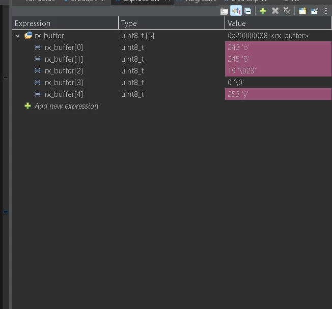

I am using STM32 H563 Nucleo board to read the configurational register (address = 0x24) of STPM33 evaluation board using SPI protocol but while debugging the code i am getting random values on each transmission.
Firstly i am transmitting an bytes {0x24,0xFF,0xFF,0xFF,0x99} to set the read pointer to address 0x24, and then again transmitting bytes {0xFF,0xFF,0xFF,0xFF,0xDE} to read the data of register. After each transmission i am receiving random values.

Below are the images of data received after each transaction:
Also i am attaching the main.c file for further reference.
