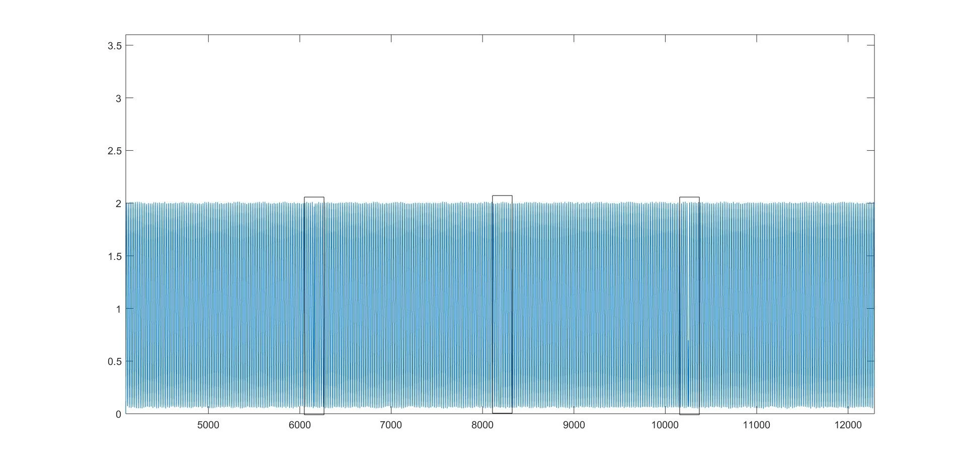

I am working on a project in which I have to store the data from my ADC (in continuous mode with DMA) on a SD card (with FATFS and SDMMC1) without losses. I try to use a ping pong buffer but when I want to change the bufferinwhich the ADC store values I have to stop my adc and restart it with the good buffer in parameter. Thus I lose a lots of data because of that.
Do you have a better solution to this matter ?
I also use my SD card in 1 bit mode because when I want to use it in 4 bits mode I have the RXOverrun flag. Fatfs is not configure to work with DMA because I don't know how to do it.

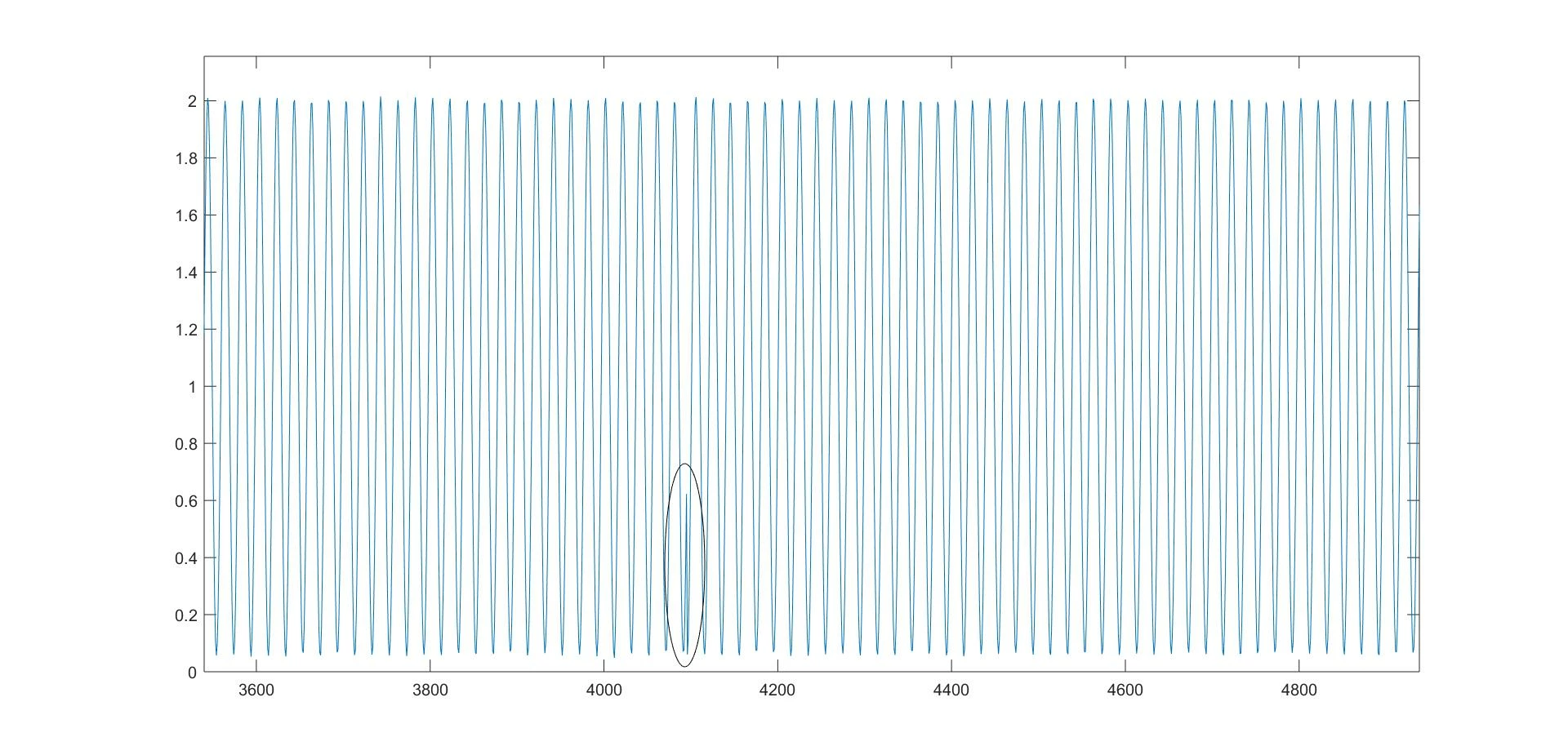

Tesla DeLorean
Tesla DeLoreanBest answer
Guru
Aug 12, 2020 10:51 AM UTC
Needs to be large enough, and some multiple of sectors to write efficiently. Say 8192 bytes or 32768 as it flushes the inactive portion of the buffer.
Hard deadline is the time the ADC takes to fill the active half of the buffer.
Should get the SDMMC implementation working properly first, and 4-bit, and speed benchmarked.
Where using DMA to fill from ADC, and using polled writes from memory for SDMMC, need to watch cache coherency​

waclawek.jan
Aug 11, 2020 8:14 AM UTC
Use circular DMA, store at half-complete and transfer-complete interrupts.
I have no idea whether this can be clicked in Cube.
M.CHN
M.CHNAuthor
Aug 11, 2020 8:44 AM UTC
Thank you for your help. DMA was already configured in circular mode and even if it is better than before, when I store at half-complete and transfer-complete interrupts I still lose datas when I change the buffer (in the black rectangles on the photo)0693W000003Ov0hQAC.jpg.
waclawek.jan
Aug 11, 2020 10:18 AM UTC
Using HAL_ADC_Stop_DMA() / HAL_ADC_Start_DMA() defeats the point of circular DMA. You don't want to stop/start ADC/DMA.

M.CHN
M.CHNAuthor
Aug 12, 2020 7:54 AM UTC
This seems to be better, but I still have some losses like on the photo. I am wondering if it could come from the writing speed of my SD card which is to slow. More I don't use 4 bit mode for SDMMC1 because I always have Rx overrun error :grinning_face_with_sweat:.
***EDIT***
The "losses" seem to come from ADC because I have "glitches" like in the photo even in the middle of the half part of the buffer for exemple.
Thanks for your help :D 0693W000003P8BsQAK.jpg

M.CHN
M.CHNAuthor
Aug 18, 2020 7:10 AM UTC
I finally succeded in using my SD card in 4 bit mode. I was still loosing some datas but when I set my buffer length to 32768 as @Community member​ told me to do all work perfectly.
Thank you all for your help. :grinning_face:
