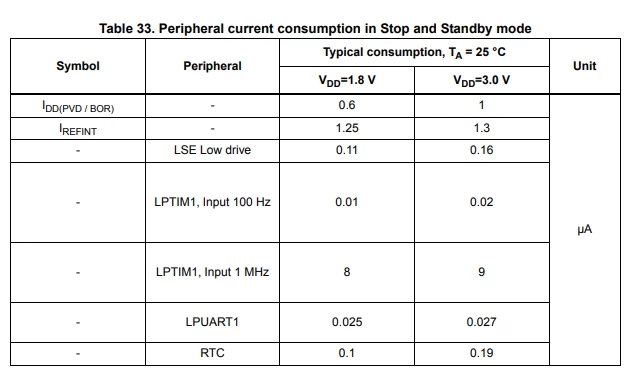

KDJEM.1
November 15, 2022
Hello @LaurentLef​,
Please check the parameters mentioned in the DS11100 and precisely in table 33 (as shown below).
Thank you for your contribution in the ST community.
Kaouthar
LaurentLef
November 15, 2022
Thanks for this information.
Something bizarre: all the peripherals (Bor, PVD, ADC, and comparator) which use the VREFINT are off and yet the VREFINT_RDY_FLAG is at "1" in the SYSCFG_CFGR3 and PWR_CSR registers.
Does this mean that the Vrefint is active and therefore consumes 1.3µA in stop mode?
