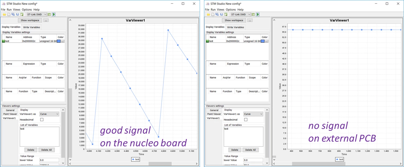

Hello!
I used STMStudio on the NUCLEO-F303RE for plotting signals and it worked fine. Now I built my own PCB with an STM32F303RC, broke off the debug-part of the NUCLEO board and startet debugging with the SWD connector. Everything worked fine in the Truestudio and the signals look good. So, I wanted to stream the signals with STMStudio. But, it doesn't work. Instead of a any signal I only get a single value which is far off from the data range. I even got the SWV in TrueStudio working. I also performed a check on SWCLK and SWDIO. Both look fine.
Any ideas?

Posted on June 15, 2018 at 13:43
I solved the issue myself. The boot0-pin was not grounded properly and I fixed it now.
Anyways, it's interesting that the TrueStudio debugger doesn't care about the boot0-pin only the STMStudio.
