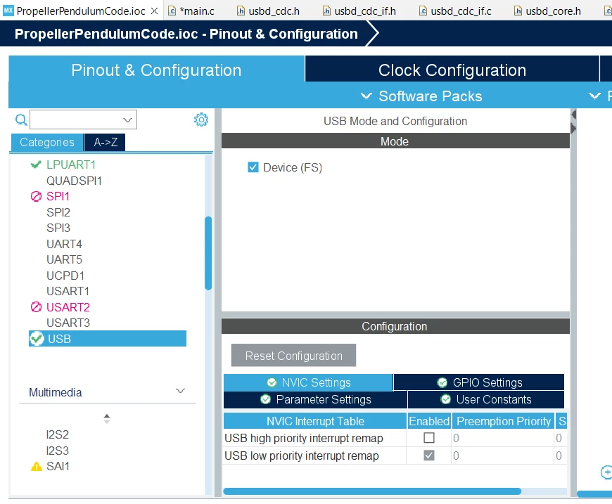

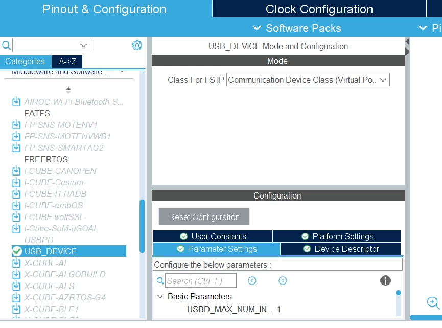

I´ve activated the usb in the communication section and the usb_device in the middleware where i also set the communication device class option.
Afterwards i solved the clock issue using the HSI48RC clock for usb.

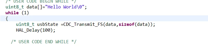

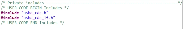

But from that on the next steps are unclear to me. Can i now just use the "uint8_t CDC_Transmit_FS(uint8_t* Buf, uint16_t Len)" function to transmit data? This function is located in the usbd_cdc_if.h/c file.
I tried a short example using this function to send a short hello world char array but it didn't work. So i think i missed something.

Hi @j_ic
First, you can find in UM1734_STM32Cube.book the documentation for device library. Second, you can have a look a the following example STM32CubeG4/Projects/STM32G474E-EVAL/Applications/USB_Device/CDC_Standalone at master · STMicroelectronics/STM32CubeG4 (github.com) developed for the same chip on eval board. Maybe, your implementation is just missing clock recovery synchronization CRS.
