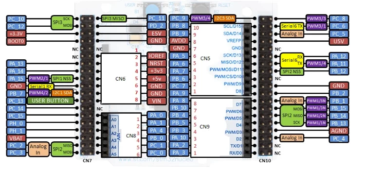

Hi JW,
Thanks for trying it out I have just had a closer look and something really odd is happening if you use "UART2_send" it transmits to UART1 TX (PC4) and if you use "UART1_send" it transmits to UART2 TX (PA2)? I can't workout why it's doing this as the UART send commands it clearly states the correct Registries:-

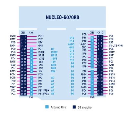

Hi JW, Now it explains as I used the incorrect pinouts and the pins where swapped! as below diagram (wrong one is at the bottom).

Where is that incorrect picture from?
