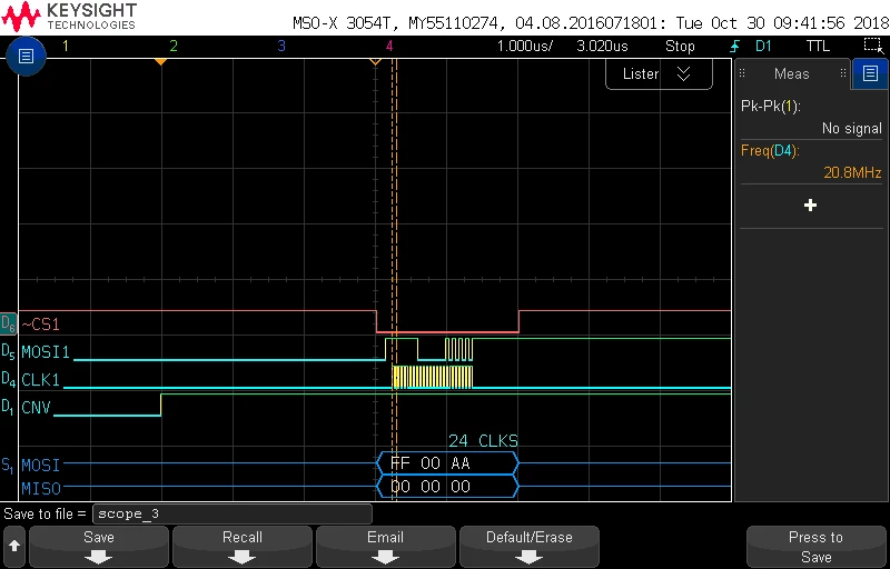

OK, I got this to work as follows (thanks again for the pointers @Community member​ @Bob S​ !):
  1. DMA for SPI TX (DMA1 stream 4) setup for 3 one-byte transfers for the outbound SPI data, triggered by SPI’s TX data empty, but not yet enabled.
  2. DMA for SPI RX (DMA1 stream 3) setup for 3 one-byte transfers, triggered by SPI RX data available, with the DMA transfer-complete interrupt enabled, and DMA enabled.
  3. DMA for TIMx_CC3 (DMA2 stream 6) set to transfer a 32-bit word to the DMA stream controlling SPI TX (so that TIMx_CC3 will effectively enable SPI transmit of 3 bytes), and DMA enabled.
  4. The externally-generated ADC conversion strobe CNV is connected to and triggers:
  • external ADC’s conversion strobe input
    • TIMx_ETR input, timer in slave trigger mode (on ETR) and One-Time-Pulse mode.
  1. TIMx_CC2 delays for ADC 3uSec conversion time, then lowers CH2 output (connected to SPI CS). At end of overall timer period (ARR = 5uSec), CH2 output reverts to high.
  2. TIMx_CC3 delays additional CS-time, then CC match triggers DMA request for memory→peripheral (DMA2 stream 6). This starts SPI transmission, which in turn starts SPI reception.
  3. After DMA for SPI RX (DMA1 stream 3) completes 3rd transfer, DMA-complete interrupt triggers ISR.
  4. ISR:
  • Process received 3 bytes of SPI data.
    • Reset all 3 DMA streams for next cycle. For each DMA stream:
  1. disable stream
    1. clear all DMA completion flags
    2. reset NTDR
    3. enable stream except SPI TX (SPI TX will be enabled by timer next cycle).
Here's the picture:
PS: As you guys hinted, the HAL/LL stuff was more in the way then helpful, so I ended up doing the peripheral initialization the old-fashioned way (const structure to initialize entire peripheral register set, then enable when ready). Also CubeMX-generated code failed to initialize all the required registers.

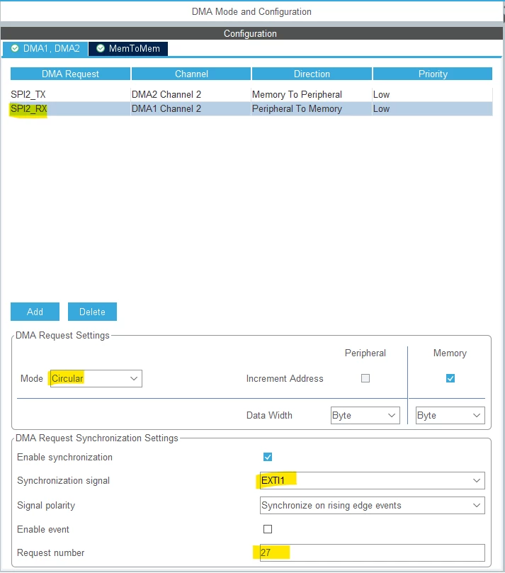

July 20, 2024
>It can't be. Timers can be triggered from external pin, and then in turn trigger DMA transfer(s).
Why not? There is an option given in CubeIDE to synchronize by EXTI, so what is that for? Why should I trigger DMA by a timer instead of directly by EXTI1?
I have gone through the DMAMUX and DMA sections of the reference manual RM0432. It states:
"Each DMAMUX request line multiplexer channel x can be individually synchronized by setting the synchronization enable (SE) bit in the DMAMUX_CxCR register. If a synchronization event occurs while there is no pending selected input DMA request line, it is discarded. The following asserted input request line is not connected to the DMAMUX multiplexer channel output until a synchronization event occurs again."
This means that DMA would wait for the EXTI every time to start the DMA transfer, right?
I am using the STM32L4P5-DK and ADS131M08 ADC. I need to get 8 channel samples (27 bytes with status response). I am getting DRDY every 125 µs (8000 sps). So, DRDY signal is taken as EXTI1 and the request number is 27. Won't the below configuration work?
Regards ,
AJ

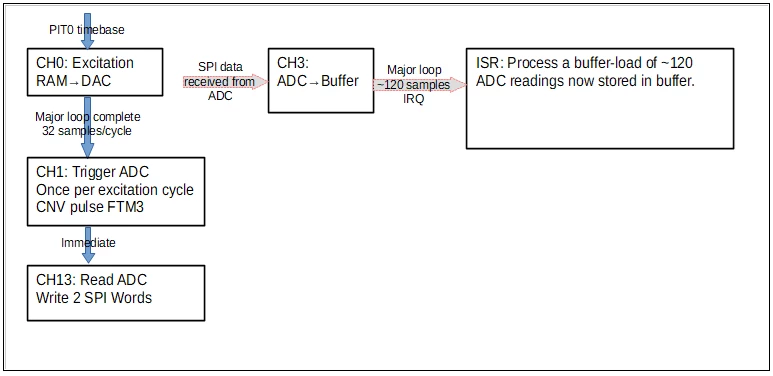

PS: Here's an example of what we did with a different vendor's DMA: Send excitation waveform via onboard DAC, initiate ADC once per excitation cycle, read ADC, accumulate 120 samples in a buffer, then invoke ISR. No CPU involvement until a pile of samples ready. Used 4 DMA channels and DMA chaining. Yes, ADC transfer was >16-bits (this MCU's SPI module supports >16 bit SPI with multiple transfers while holding CS):
PPS: DMA use for a different product (and different MCU) I did last year where CPU activity was deferred until results loaded; didn't have long SPI xfers though: https://www.silabs.com/community/mcu/32-bit/forum.topic.html/giant_gecko_control-Dd4u
