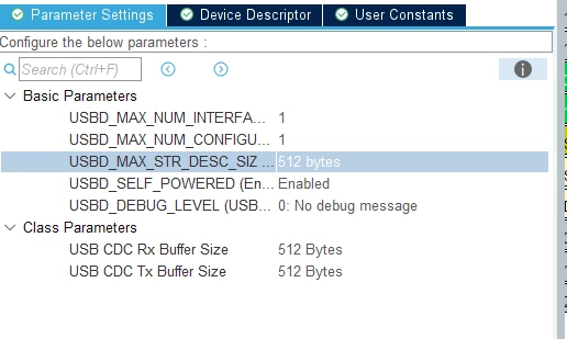

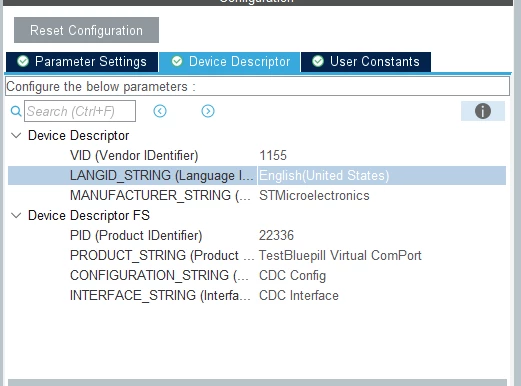

I am using a STM32F103 and having issues to make an USB application.
I generated the project using CubeMX and I am not being able to transmitt a message.
Here is the configuration:

Sincere apologies, cable was the issue. Connectors did have 4 pins but it seems only power ones were wired, tried with a new cable and it worked
