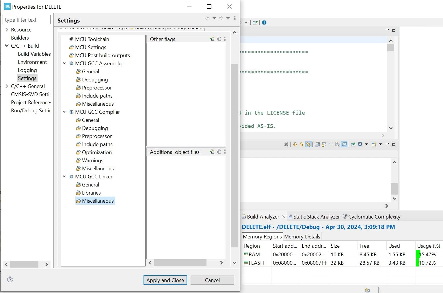

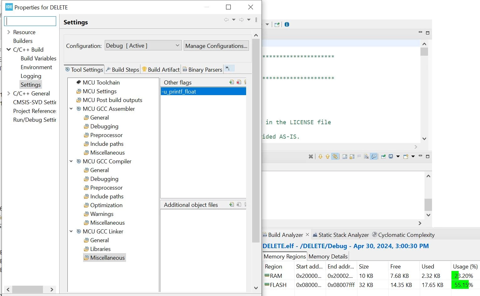

I am having stm32F103C6T6 Development Board. When i enable -u_printf_float flag for Float printing on 16x2 LCD it takes upto 15KB of total space .
Please guide. what else can be done ?
-u_printf_float Enabled :
Without Flag for Float

The stm32F103C6T6 has no hardware floating point, so it all has to be done in software - which uses up flash space.
Don't use floating point!

The math can be done without printing, and the printing portion probably isn't going to get markedly smaller on a library using an FPU, faster perhaps. The defaults for printf() is typically the double, so you'd be into the bigger CM7 FPU-D implementations for them to assist with the math.
If floating point can be removed that would save the most space. Say an appropriately chosen fixed point or scaled integer?

>>Please guide. What else can be done ?
You could learn or read about things more deeply, so you can think through the situation, rather than be guided at every step?
Perhaps use your own, lighter weight, application specific variants?
Could you convert and break down the float values into integer sub-components that you could print with the classic integer formatting methods. ie "%d.%03u"
Things like dtoa() are quite heavy, probably a large portion of the cost here.
As Andrew said, the ideal situation might be to not use floating-point. Can your number ranges be accommodated by a fixed point solution using integers?
