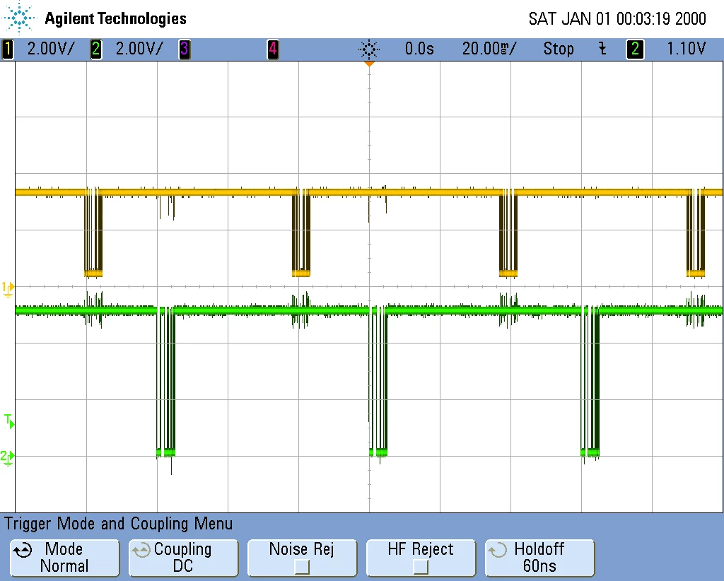

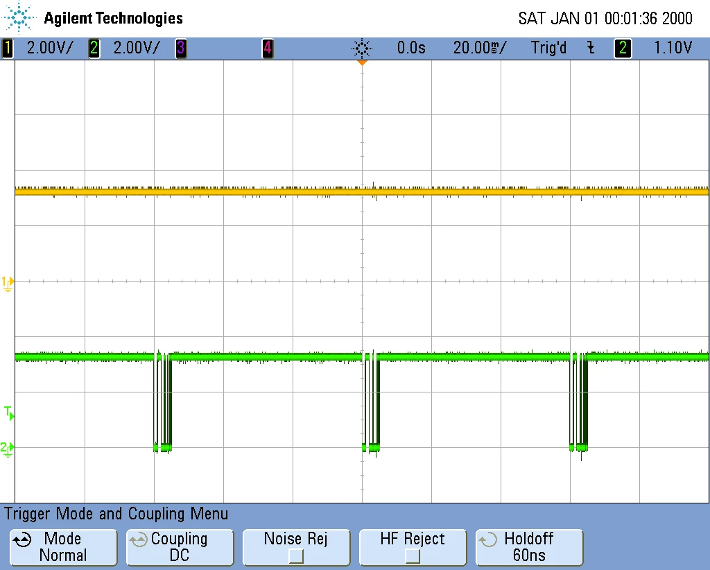

Show us relevant part of schematics and show measured signals on individual pins of H11L1 (including those you assume to be at a given potential, e.g. ground - measure continuity, assume bad solder joints).
M.HarmsAuthor
July 5, 2023
Green is the TX signal from the chip.
Yellow the RX from the chip.
Scope 12 is the isolator side of the chip.
scope 13 the PC side.
