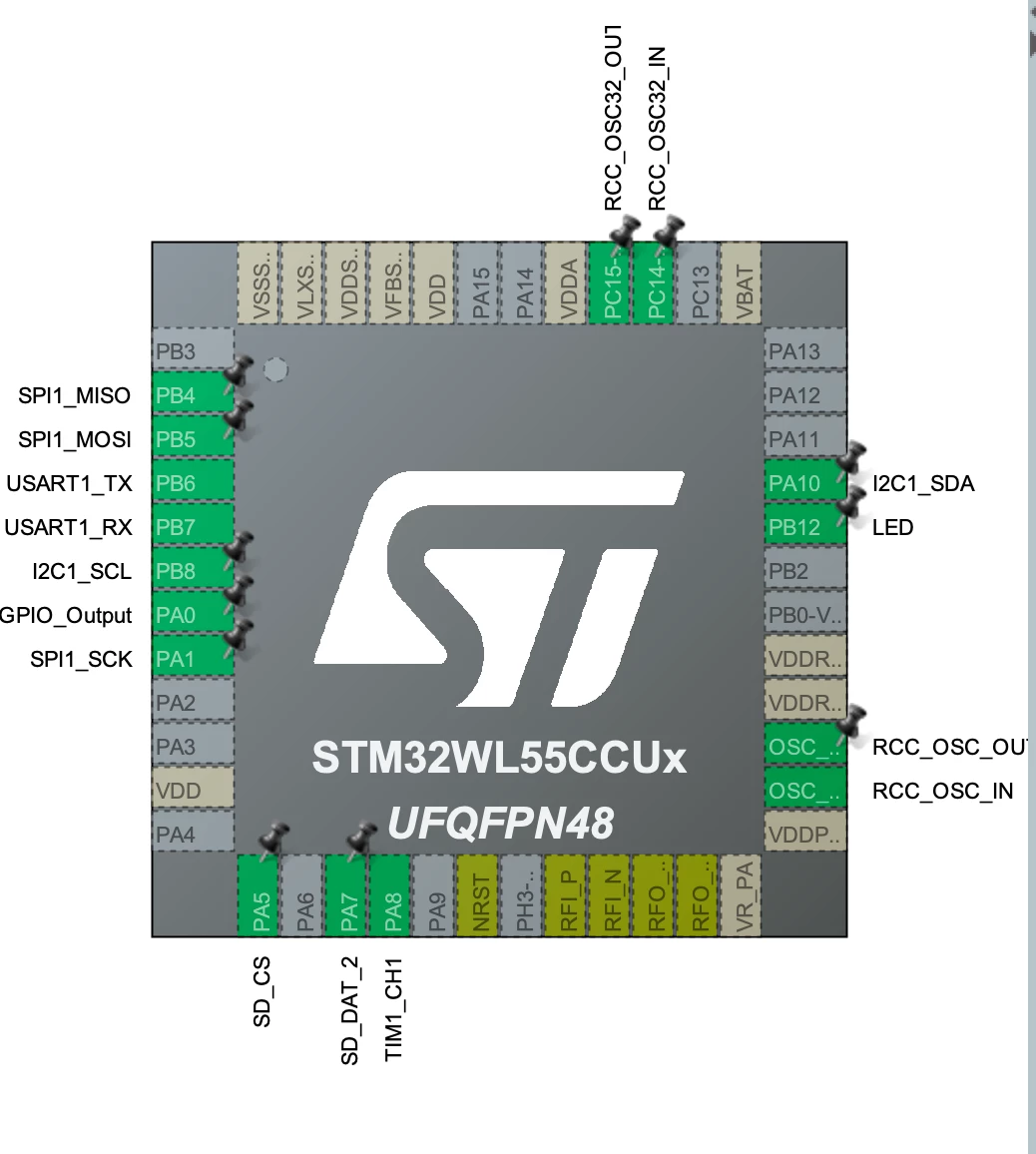

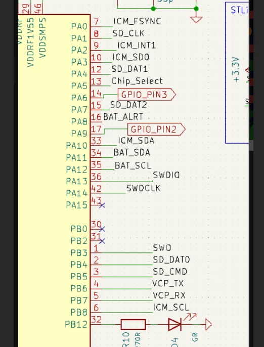

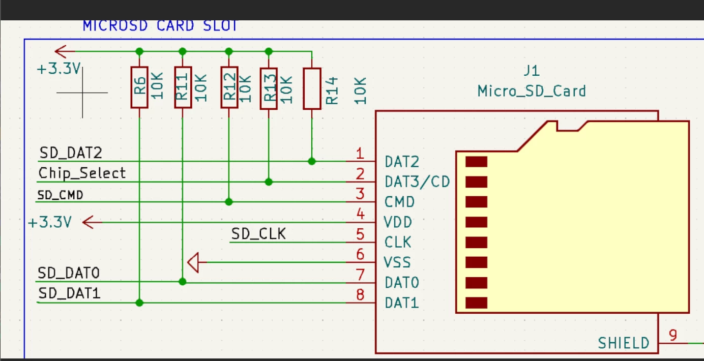

Hello All,
I will attach my PCB Layout as well as IOC file screenshot for reference. I am using this tutorial https://01001000.xyz/2020-08-09-Tutorial-STM32CubeIDE-SD-card/.
I got it working on a nucleo board, but am transitioning over to the PCB now.
After some debugging, I found that the error is coming from this function.

Specifically the error is coming from  this portion of that function:
	bsect = 0;
	fmt = check_fs(fs, bsect);			/* Load sector 0 and check if it is an FAT-VBR as SFD */
	if (fmt == 2 || (fmt < 2 && LD2PT(vol) != 0)) {	/* Not an FAT-VBR or forced partition number */
		for (i = 0; i < 4; i++) {		/* Get partition offset */
			pt = fs->win + (MBR_Table + i * SZ_PTE);
			br[i] = pt[PTE_System] ? ld_dword(pt + PTE_StLba) : 0;
		i = LD2PT(vol);					/* Partition number: 0:auto, 1-4:forced */
		if (i) i--;
		do {							/* Find an FAT volume */
			bsect = br[i];
			fmt = bsect ? check_fs(fs, bsect) : 3;	/* Check the partition */
		} while (LD2PT(vol) == 0 && fmt >= 2 && ++i < 4);
	if (fmt == 4) {
		return FR_DISK_ERR;		/* An error occured in the disk I/O layer */
	if (fmt >= 2) {
		return FR_NO_FILESYSTEM;	/* No FAT volume is found */
// ^^^^^^^^^^^^^ERROR IS COMING FROM HERE^^^^^^^^^^^^^^^
Any help in debugging is greatly appreciated. Thanks!
