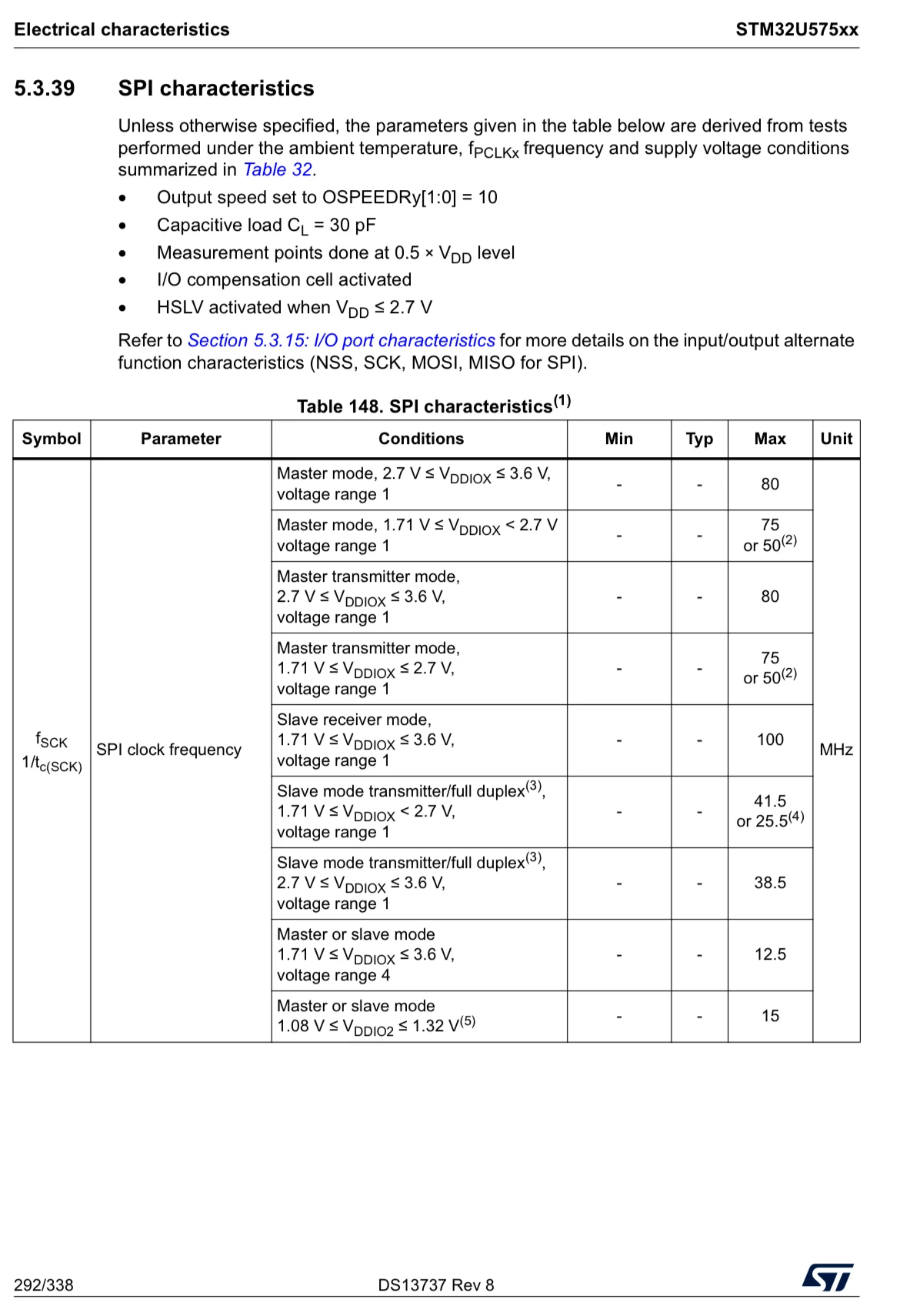

OK, the same statements found in U5A5 datasheet (not using U575):
100 MHz as SPI Slave, VDD=1V8 should be possible.
(1.71 V ≤ VDDIOX ≤ 3.6 V, voltage range 1)
I run voltage range 1.
It is just a SPI Slave:
 /* SPI3 parameter configuration*/
 hspi3.Instance = SPI3;
 hspi3.Init.Mode = SPI_MODE_SLAVE;
 hspi3.Init.Direction = SPI_DIRECTION_2LINES_RXONLY;	//SPI_DIRECTION_2LINES;
 hspi3.Init.DataSize = SPI_DATASIZE_8BIT;				//SPI3 only 8 or 16bit !!
Not very important as long as 40 MHz works (for me).
The duty cycle maybe matters (50%, as mentioned in note 3):
3. The maximum frequency in slave transmitter mode is determined by the sum of tv(SO) and tsu(MI) that has to fit into SCK low
or high phase preceding the SCK sampling edge. This value can be achieved when the SPI communicates with a master
having tsu(MI) = 0 while Duty(SCK) = 50%.
This one I cannot influence: it is generated by the OCTOSPI.
I close the ticket, never mind (don't waste your time with it. Just to have it reported as "unexpected" result.
