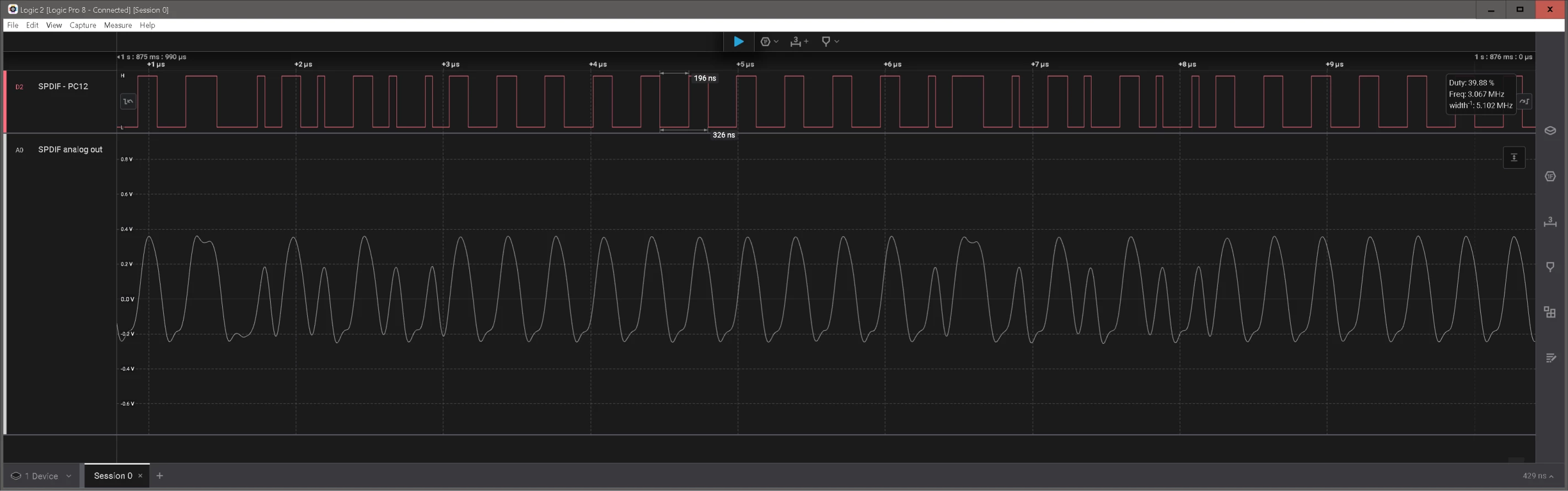

I am struggling since days to get "my audio" out via SPDIF (electrical).
What I see on scope (there is a voltage divider and cap for DC-free on PC12, Vpp is 0.6V, approx. 75 Ohm impedance):
It makes sense - but my SPDIF receiver (a STM32F769I-DISCO board, which works fine as SPDIF receiver with another source) does not get any audio (but it seems to sync and realize there is SPDIF signal, but completely silent).

But when I run this config - it seems to be completely wrong. I check with a scope the SPDIF signal and its frequency. I assume to see this:
  • 48 KHz audio, two channels, 32bit samples (SPDIF uses 24bit, but a 32bit frame) - so, 3,072 KHz
  • but SPDIF is "marked encoded", so that I expect to see on SPDIF the fastest frequency (for values as 1) is doubled, so that a sequence of zeros is 48 KHz, but a sequence of ones is 96 KHz
So, I tried to trim the SPDIF frequency via scope and I had to configure this:
PLL3P : PLL3M = 1
 PLL3N = 18
 PLL3P = 96
 fractional = 3546
//resulting in 2x 48 KHz for SPDIF signal
So, what I see:
  • The CubeMX config says "correct 48 KHz as audio" but I have to double the frequency for SPDIF. And the PLL frequency seems to be a little bit off, but OK to tweak via "fractional" (or my scope is a bit off).

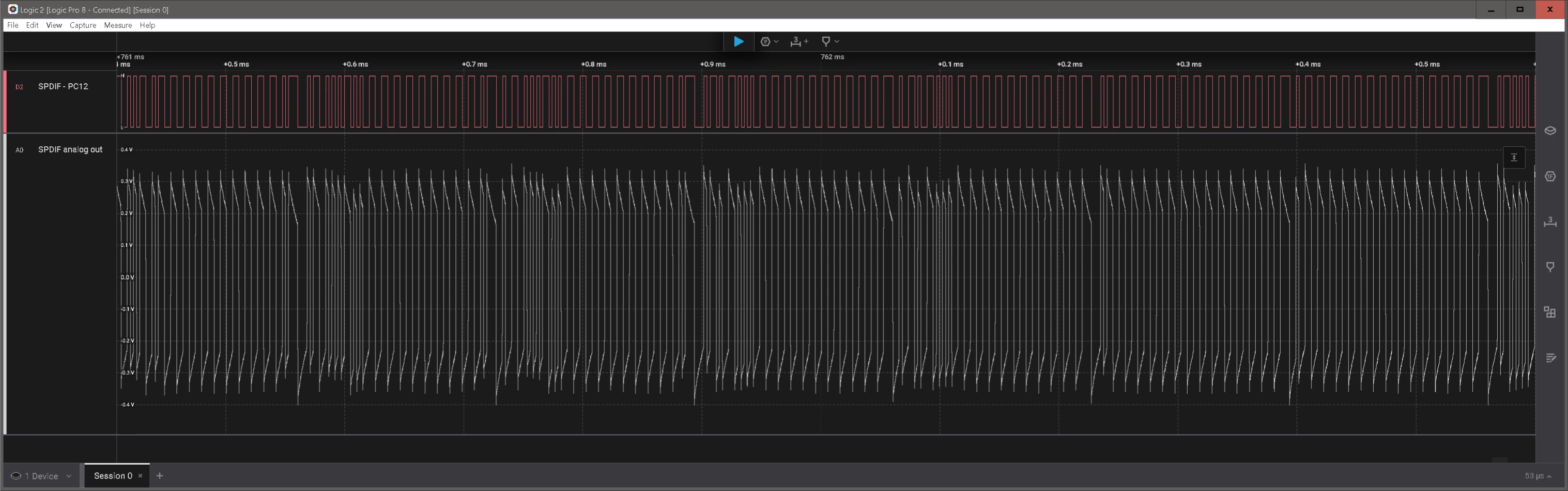

OK, I can confirm:
  1. SPDIF Out on SAI2_SD_B works:
    Even on STM32U5A5 LQFP64 package ("officially" not a SAI2 and CubeMX does not let me configure pins for SAI2) - the SAI2_SD_B can be used as SPDIF out - IT WORKS! (even on the LQFP64 package!)
  2. Yes, the CubeMX generated clock config for SPDIF is wrong - but I could fix
  3. There is no need to set the CS bits: even I have assumed it is needed to add the V, U, CS bits: no: they can remain all zero (getting 24bit audio samples from SAI1 and forward to SAI2 without modification - great) - IT WORKS!
Just:
The issue is!:
The DMA from memory to SAI_SD_B as SPDIF Out FAILS!
It writes all zero (or nothing), even the memory is properly filled with audio samples.
I have used a scope (SALEAE) and SPDIF decoder: yes, I see all words on SPDIF signal are zero on scope!
Why? No idea: the DMA from memory to SAI2 peripheral as SPDIF out is the issue.
I have generated the code via CubeMX, as circular buffer - but it does not work.
When I use Polling mode or INT mode to send the audio to SAI2_B - all works fine. Just the DMA fails.

This setting, to doubled audio frequency (96KHz), even all is 48KHz - I saw already on other projects, on older HAL drivers. It seems to me, the "bug" that the SPDIF clock config is not correct and needs a setting for the doubled audio frequency is still there.
Never mind - even I get now reasonable waveform on SPDIF, with 3.086 MHz and 3.06 MHz frequencies (as average 3.074 MHz - it should be 3.072 MHz but not possible to tweak further) - I still do not see any audio volume on receiver.

I am so lost how to get SPDIF working (and why my receiver does not get any audio samples, even it seems to sync).
BTW:
I "trust" the DMA: during debugging I saw that the DMA src pointer (from memory) is moving and seems to transmit the audio samples to SPDIF DR (data register, also correct address - but no idea what was transferred as value).
I am not sure, if 32bit with DMA works really: I have another (separate issue) where a 32bit word transfer on I2S, from Codec into memory, fails as well (I get just all zeros, even the I2S signal is completely fine).
Based on the changed bit pattern on scope (due to my sine wave in test buffer for SPDIF out) - I assume it should come out on SPDIF as well as a sine audio signal (1 KHz).
Any ideas why my SPDIF receiver does not see any audio samples?
(I have debugged a bit my STM32F769I-DISCO as SPDIF Rx: I do not see any error flags set but the receiver buffer is really all zero - why?) I trust a bit this SPDIF receiver because it works if I play SPDIF from another setup (mainly the same used as Tx) and it works.
So, something wrong with my new STM32U5A5 setup, maybe the signal levels (external circuit) or the clock configuration for SPDIF, or the buffer content, or the STM32U5xx has an issue with SPDIF via SAI.
If you have any clues... very appreciated: I am out of ideas.
