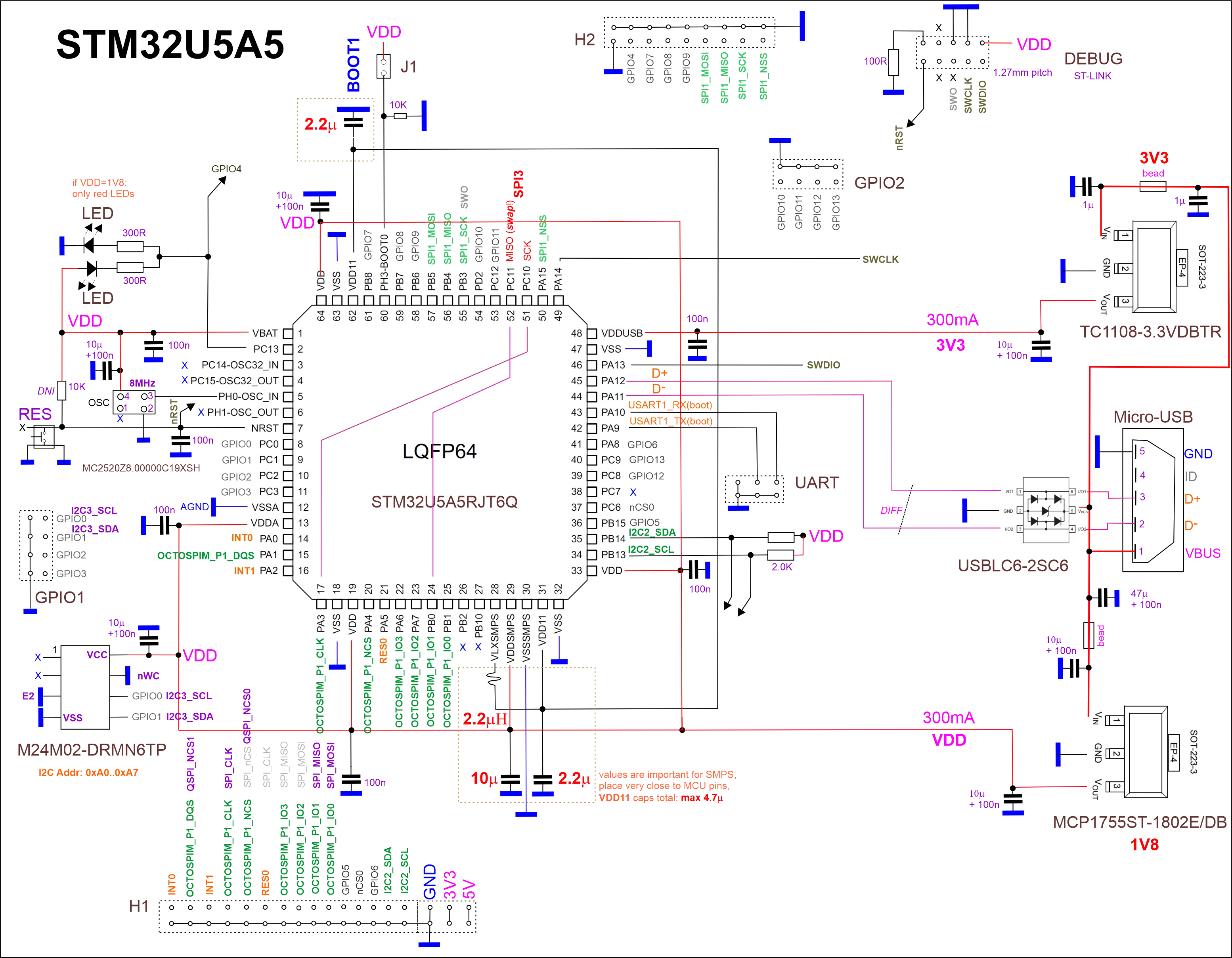

See my schematics for it at the end:
connect SCK from OCTOSPI Master to SPI3 Slave SCK and listen on OCTOSPI IO1 as SPI3 Slave MOSI (RX). It works (up to 40 MHz).

Schematics:
Here the schematics I use on my PCB (SPI3 is a Slave listener on OCTOSPI signals). On a NUCLEO board you need external wires to accomplish the same (see the pink traces under the STM MCU chip, on NUCLEO board as flying wires).
Only this gives me a REAL "regular" SPI on OCTOSPI (with sharing the same pins).
