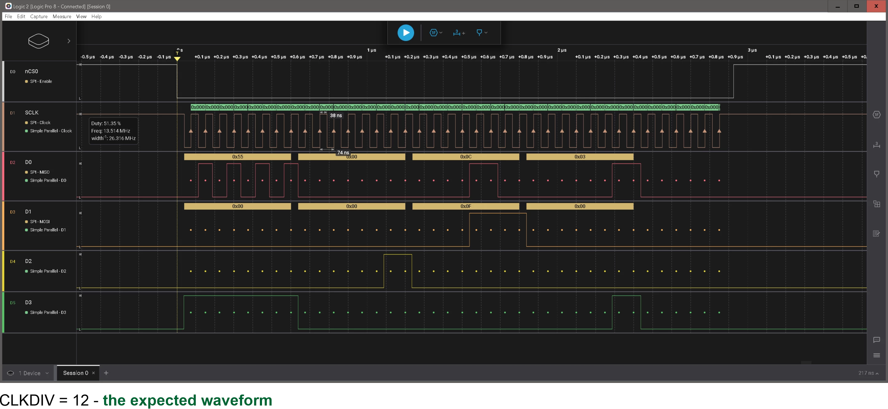

I want to use OCTALSPI as QuadSPI (QSPI), esp. with VDD set to 1V8. I want to get (at least) 30 MHz SCLK working on QSPI.
But I cannot go faster as 12.195 MHz, which is associated with a OCTALSPI clock divider set to: 13.
Symptoms:

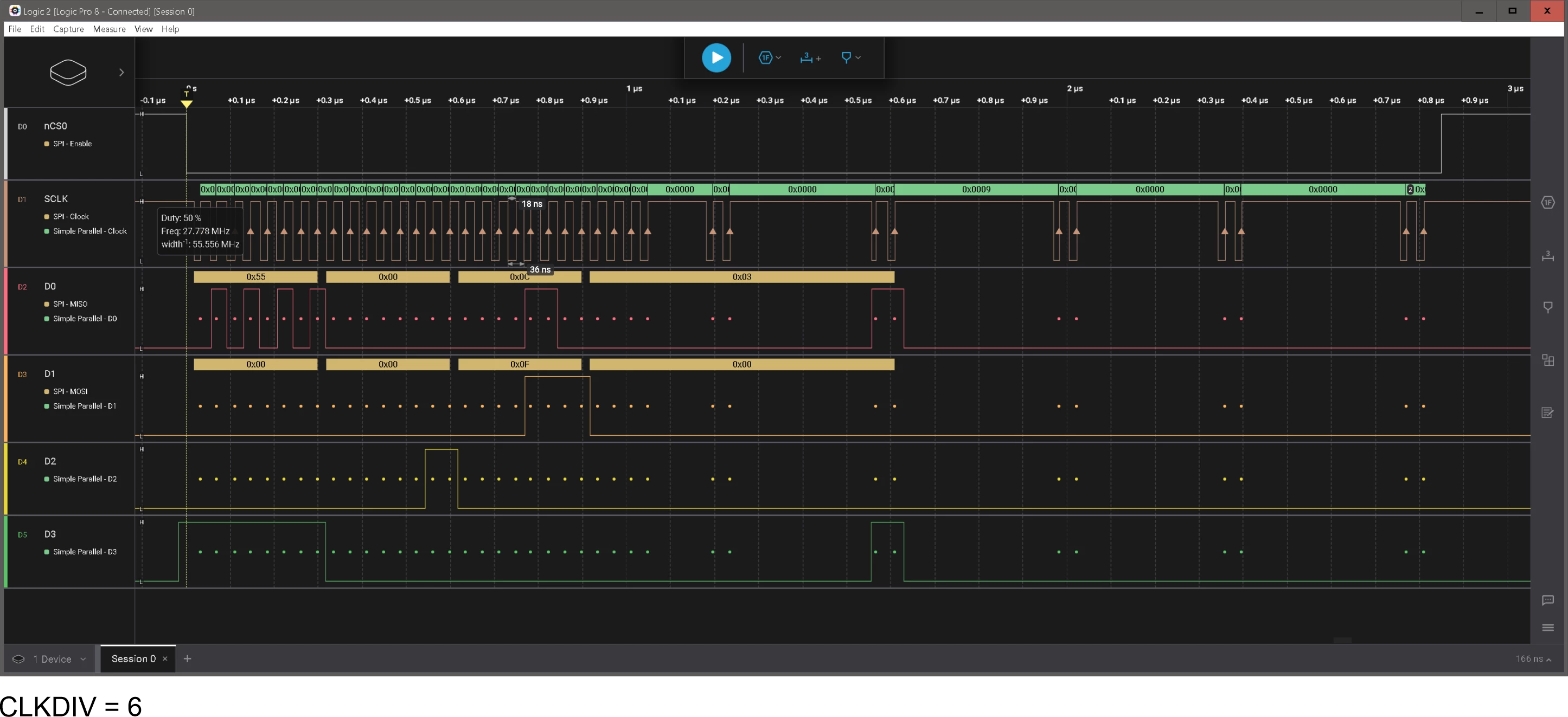

VDD = 3V3:
down to clock divider = 13 - all looks fine

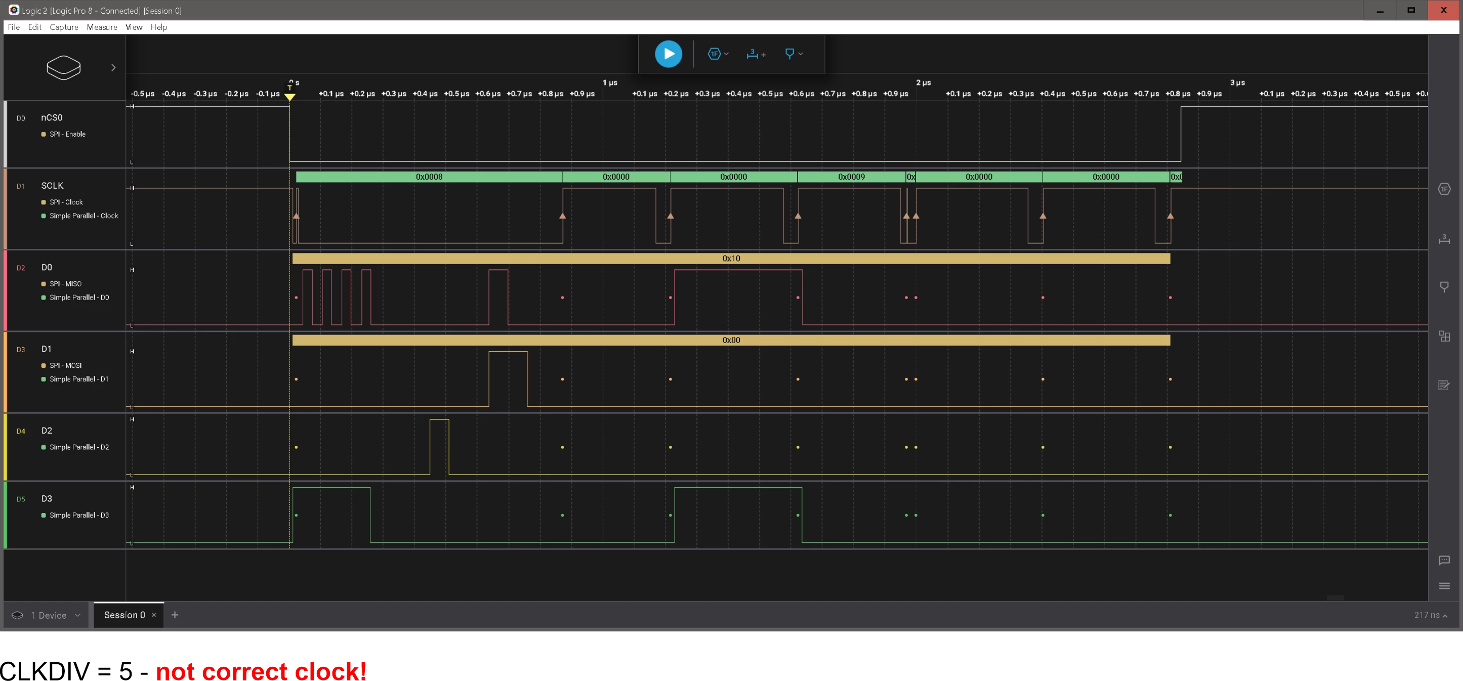

clock divider lower (for faster speed): looks different on SCLK but might be OK (still reasonable, even with gaps)
the minimum for clock divider with VDD = 3V3 is: 6 (resulting in 27.778 MHz - I want to see 30 MHz working)
anything faster (smaller clock divider) FAILS: there is no SCLK anymore

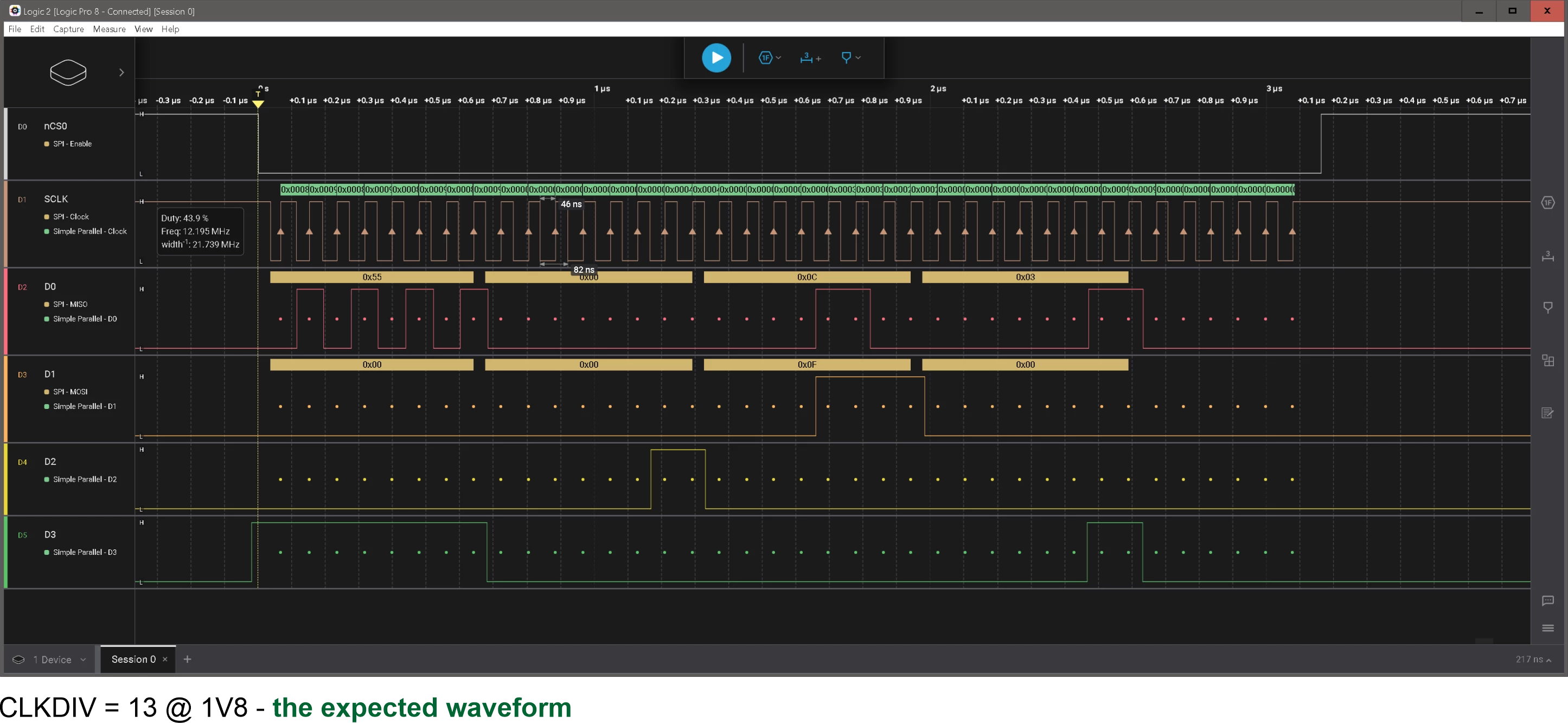

VDD = 1V8:
all fine down to clock divider = 13 - the same as 3V3

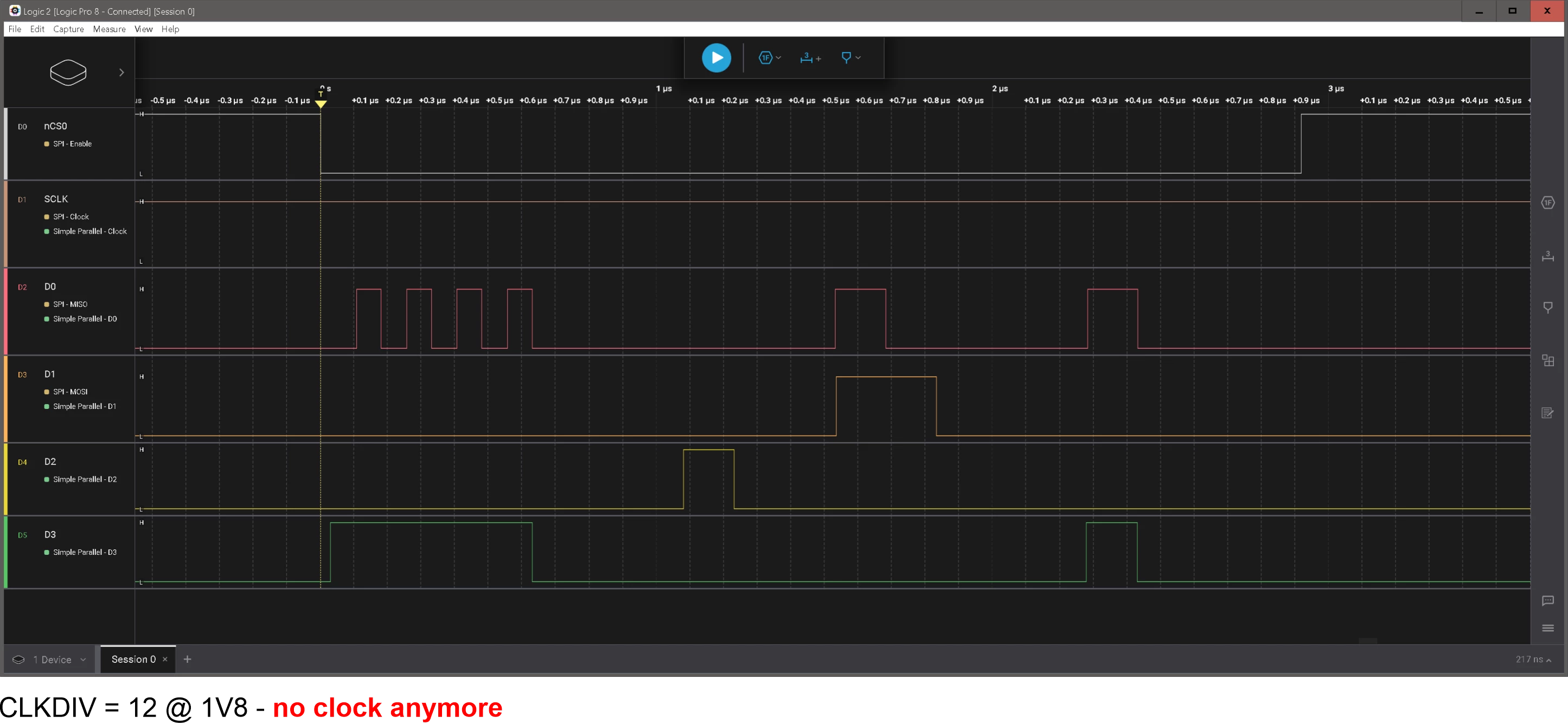

clock divider = 12 - FAILS completely! no SCLK anymore!
with VDD = 1V8: I cannot even reach the same speed as with 3V3

Waveforms:
VDD = 1V8:
It fails immediately with CLKDIV = 12 - where it was working still (a bit) with 3V3!
What is wrong?

The fact that the data words are spread out now (and I see gaps in SCLK) might be obvious: I use data transfer via OSPI_WriteReadTransaction() which sends all in indirect mode. All is based on SW polling (checking the FIFO status) and FW can be slow and cause these gaps (but fine).

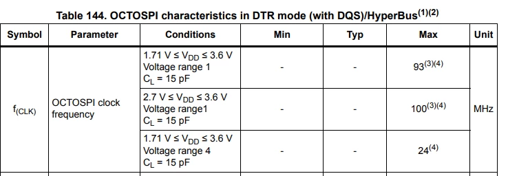

I am frustrated. I have changed to STM32U5xx because of the QSPI support (even it lacks some features, like "regular SPI"). Now I realize that it does not work as specified (in datasheet), e.g. to get 93 MHz SCLK in voltage range 1, even on VDD = 1V8. I get just 27 MHz maximum (and just with 3V3, not 1V8).
It does not work for me as I need (1V8 and 30 MHz).
And the Errata document is already pretty long for OCTOSPI (10 entries already). Maybe you had to add a new one and correct datasheet and RM for a speed limitation on OCTOSPI.   ;) LOL

It is mentioned in the datasheet that the Octo-SPI  pins support 'very high' and 'high' functionality. I think the AN5050 precisely section 6.2.3 OCTOSPI GPIOs and clocks configuration can help you to configure the OCTOSPI GPIO pins.

Yes, AN5050 says clearly on page 27:
Note: All GPIOs have to be configured in very high-speed configuration.
This is the answer (and confirms what I have realized).
I am aware of the debug and optimization flags (for debug I use -g3 and -Og).
I was trying to get rid of the byte bursts on QSPI. And this optimization setting has a small influence: byte bursts happen later now (when set for -none and -O3).
Just not yet successful to have a "gap-less" stream of words on QSPI. After a while it turns into "byte bursts" (two clock cycles for 8bits but a gap between these bytes, even all as 32bit words). Using the FIFO (other thresholds) does not help.
But OK: it works still (waveform is correct). All fine for now.
