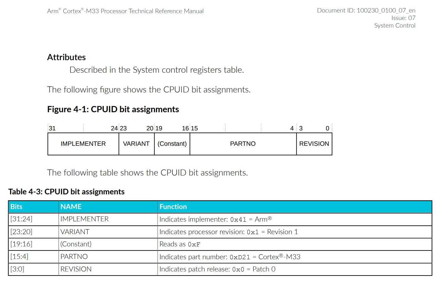

Sorry for the inconvenience. CPUID registers are detailed in the Arm® Cortex®-M33 Processor Technical Reference Manual

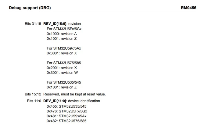

The reference manual says nothing about REVID and CPUID.
Edit: but it does say stuff about REV_ID and DEV_ID, which is what you want.

Sorry,
"Check section 76.1 in the reference manual: Unique device ID register (96 bits)" (not seen here as response, but I got it in my email) - it is NOT what I was talking about (I know this register: useful for USB IDs, ETH MAC addresses, ... I have used already on other projects).
Yes, I know this ARM document where I can figure out it is a CM33 (this 0xD21). The CPUID is clear for me.
I was asking about the REVID, which seems to be different, depending on U5A5 vs. U575.
I want to know if it is a U5A5 or a U575 (not just if CM33).
REVID register is not documented (and CPUID coming from ARM specification/doc is not mentioned, but obvious for me as part of the ARM IP used).

Tesla DeLorean
Guru
February 3, 2024
tjaekelAuthor
Lead II
February 3, 2024
Wau, cool. Thank you very much
(exactly what I was looking for)
Best answer I ever got in this forum...
