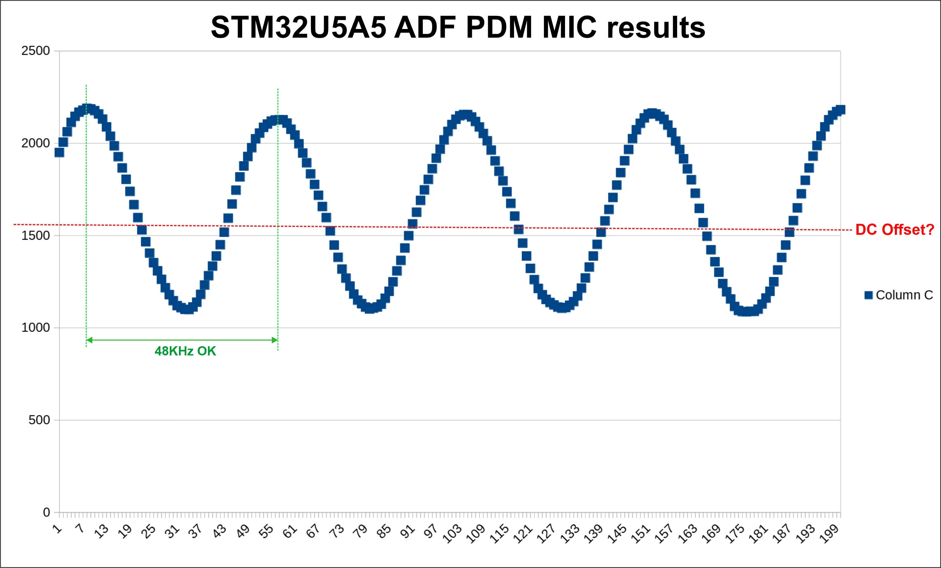

  2. I have debugged the code and I have dropped the buffer content displayed in debugger into Excel/LibreOffice (to get a graph):
    I was playing a 1KHz sine wave from smartphone speaker and I can see it - cool, the PDM MIC works and gets the audio signal.
    But:
    a) There is a DC offset (around value 1600). I see this DC offset also with a quiet signal (just ambient noise):
        all values are around 1600 (plus/minus noise).
    b) Where is this DC offset coming from?
    c) How to set the output data size, e.g. 16bit signed PCM?
       The buffer is defined as: int16_t RecBuff[REC_BUFF_SIZE * 2U];
       Is there a config to force 16bit signed? (and why I never get the full swing?, or this DC offset?
       My gain setting is 0.)

I've found a way to get rid of the DC offset: enable the High Pass Filter on ADF:
 AdfFilterConfig0.HighPassFilter.Activation = ENABLE; 	//DISABLE; this seems to remove the DC offset

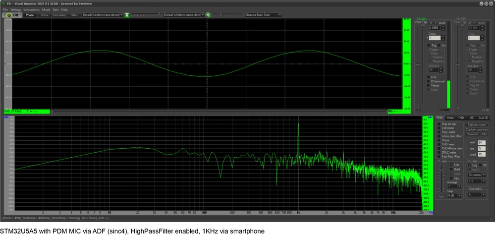

Here, how it looks like with ADF as PDM MIC input and a 1KHz sine wave from smartphone (pretty good):

BTW: I have played with the gain for the ADF filter.
The comments in code say this:
/*!< Filter gain in step of around 3db (from -48db to 72dB). This parameter must be a number between Min_Data = -16 and Max_Data = 24 */
What happens is:
  • setting gain to 10 (approx. 30dB, which works on a SW PDM2PCM filter, e.g. on Portenta H7) - the signal is completely saturated!
    (just 32767 as all values)
  • if I use 1 (as +3dB = doubled amplitude): the DC Offset is now doubled!
I "must" get rid of this DC Offset, otherwise the gain setting does not make any sense!
It would move the DC Offset into saturation and the signal is clipped/lost (and not really amplified).
How to avoid this DC Offset?
