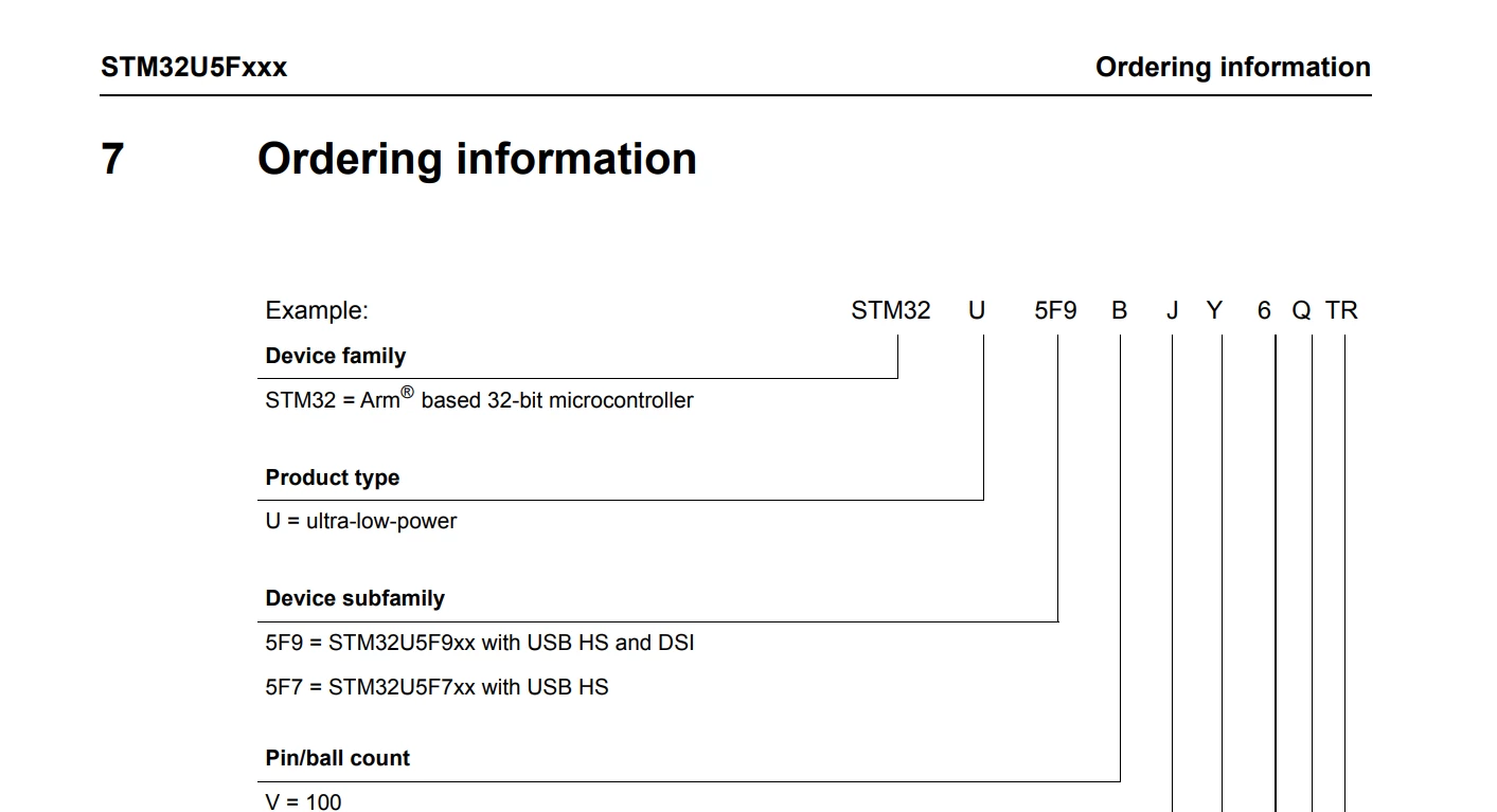

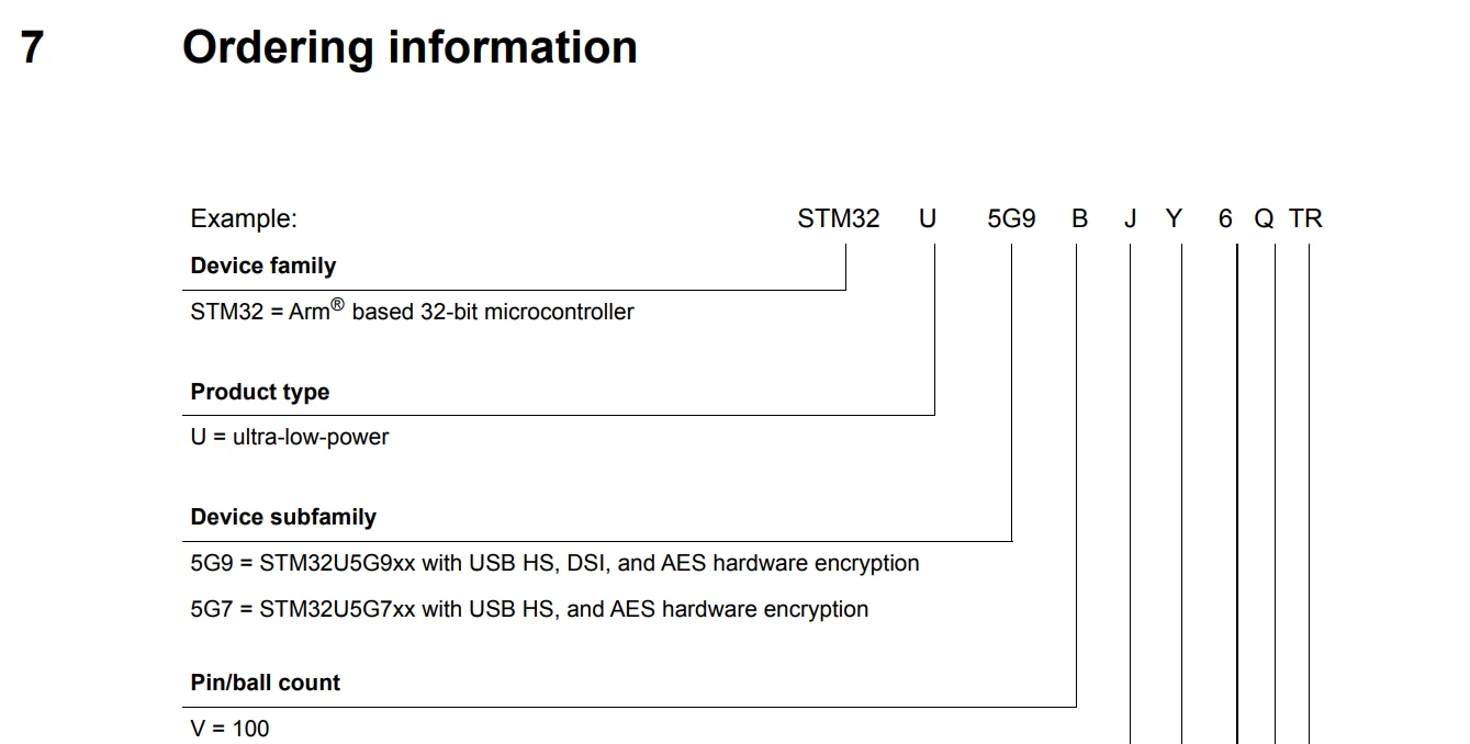

Dear @logstream76 ,
You can check at end of the datasheets the Ordering information.   MIPI DSI is only available for STM32U5G/F9 version not for STM32U5G/F7 version
Hope it helps you.
STOne-32.

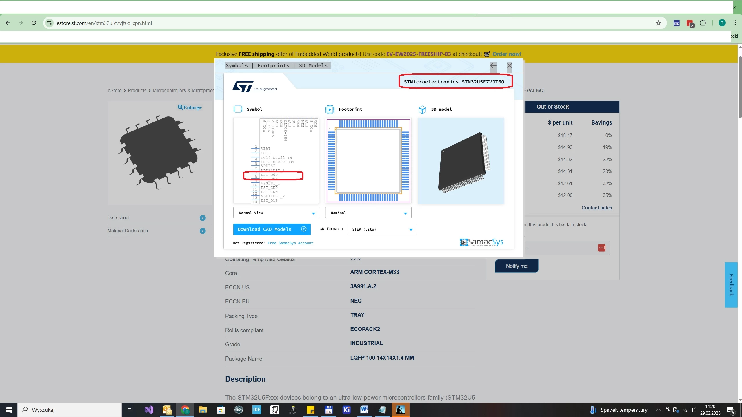

Mar 29, 2025 1:27 PM UTC
Thank you.
The schematic symbol shown in your e-store is misleading.
It shows that U5F7 also has DSI pins:

Mar 29, 2025 2:18 PM UTC
Dear @logstream76 ,
Thank you , we will check it ! A bit complex to handle common Libraries & symbols for different parts .
Ciao
