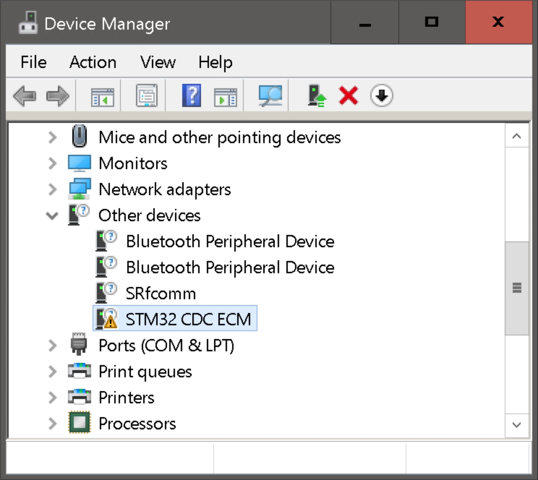

  • an "Other devices" in device manager (the driver is not found):
No idea what to install on a Windows OS to make the device driver happy.

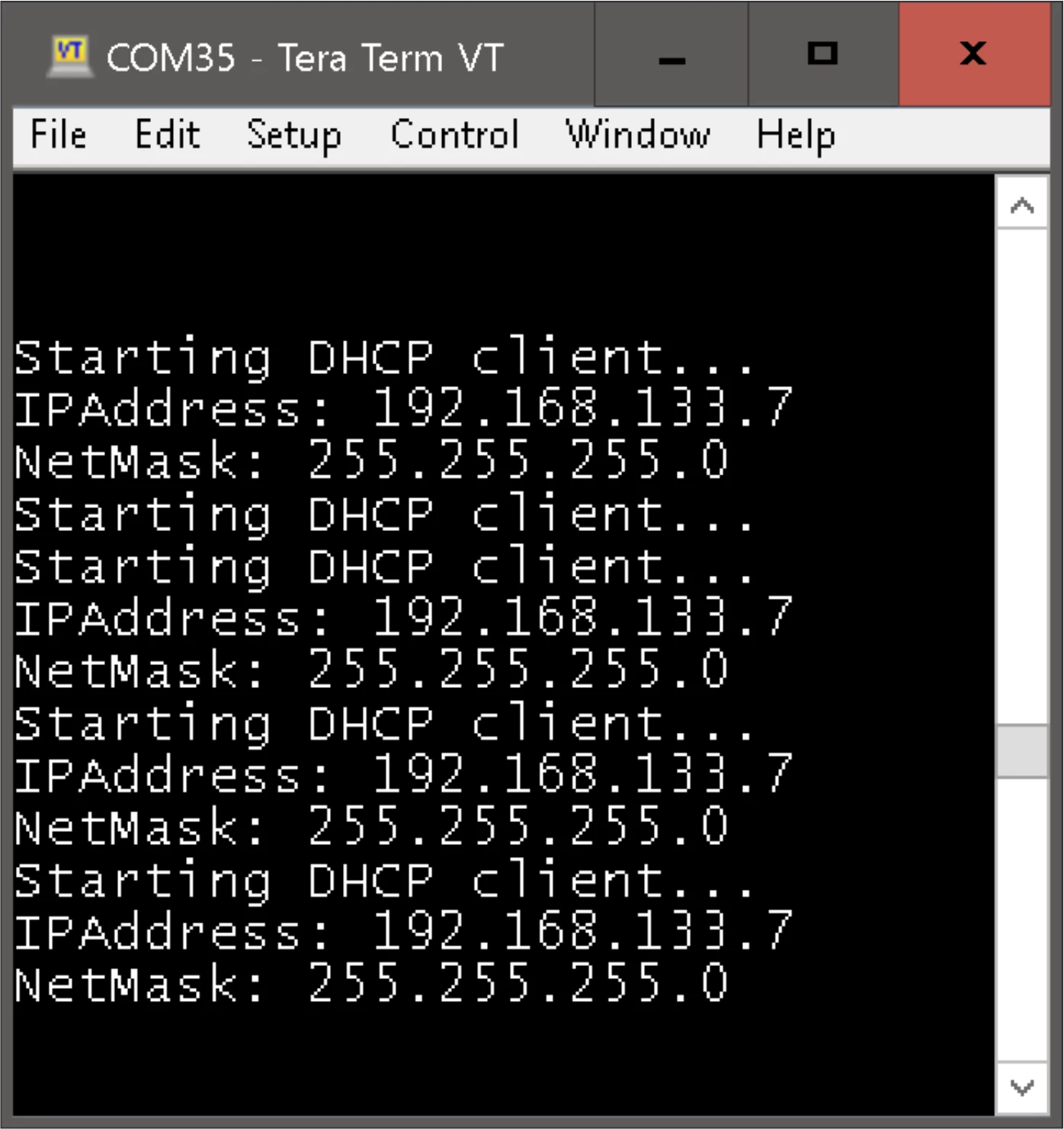

  • it does not progress on DHCP server: the MCU does not get any IP address (and the event for IP address changed is not coming)
If I try on a MacOS:
  • it looks like I see a new ETH network interface: an "en4" is there when I have connected the MCU board (via USB and FW running as USB ECM, without MCU it is not there)
  • but the FW does not progress here in the same way: it does not get an IP address via DHCP

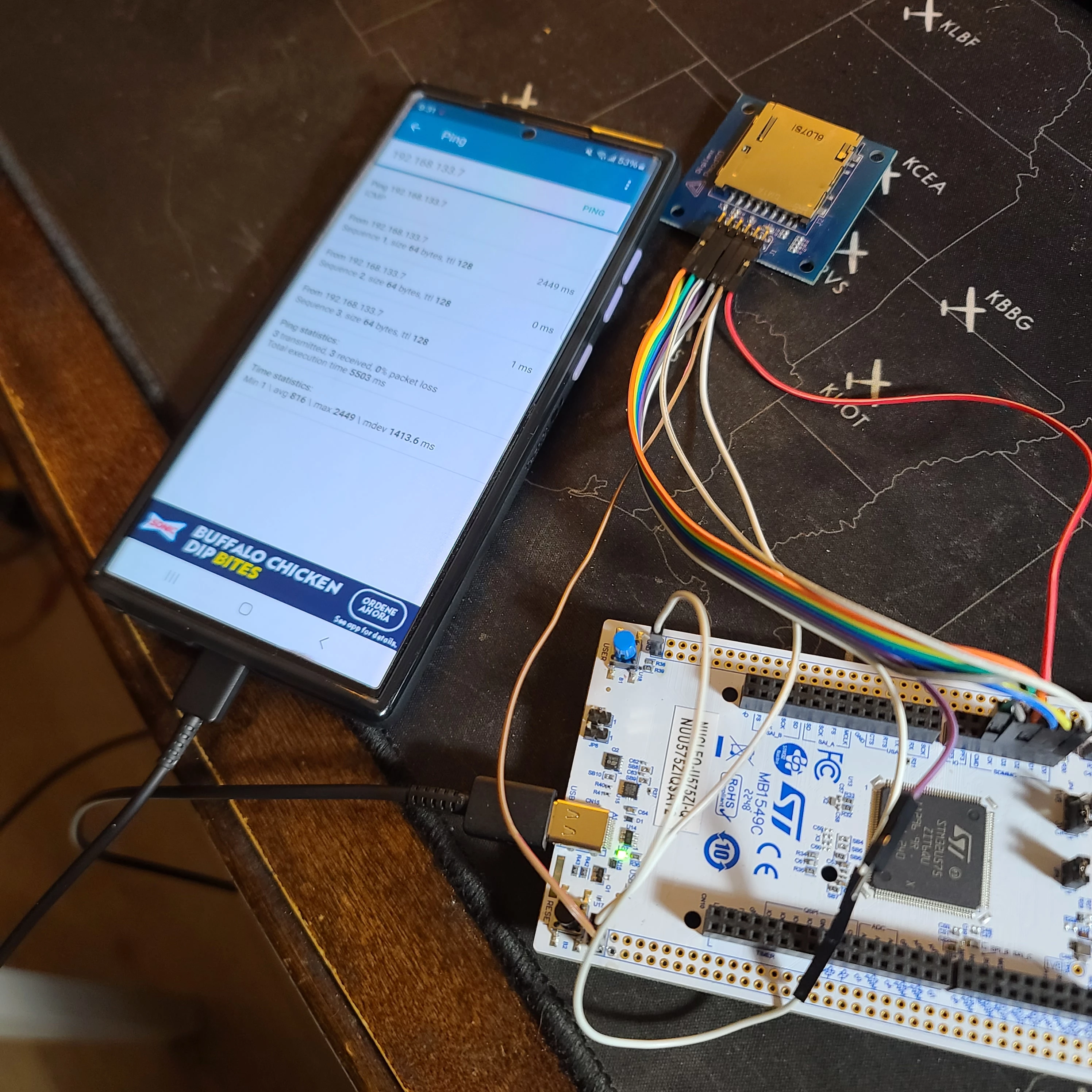

Another progress: I can see my NUCLEO-U575ZI-Q board on an Android phone! Cool.
What I have figured out on Internet:
  • USB EMC is NOT supported by Microsoft OS: you would need a special vendor driver (and I could not find any USB EMC driver, STM does not provide any...)
  • (only) RNDIS is supported by Windows (very old), but it is not the same as USB EMC:
    all the RNDIS drivers I tried to install - FAIL (on my Windows 11 PC, "driver cannot be started")
  • I do not want to go with RNDIS (too old, hard to find STM32 examples, all new Middleware with AZURE does not seem to have RNDIS): it would need anyway a different USB stack on MCU board (and hard to find one, just very old stuff, not for my MCU...)
But USB EMC works fine on Linux, e.g. MacOS, Ubuntu Linux (not tried) but for sure on Android!
So, I could enable "Ethernet tethering" on my Android phone:
  • I can enable - a very good indication: it means: the USB EMC is recognized (provided by my MCU)
    (if MCU is not providing an USB EMC or it is not connected/not running - not possible to enable - great to see it works)
  • I can also "ping" the IP address (reported on ST-LINK UART) - works

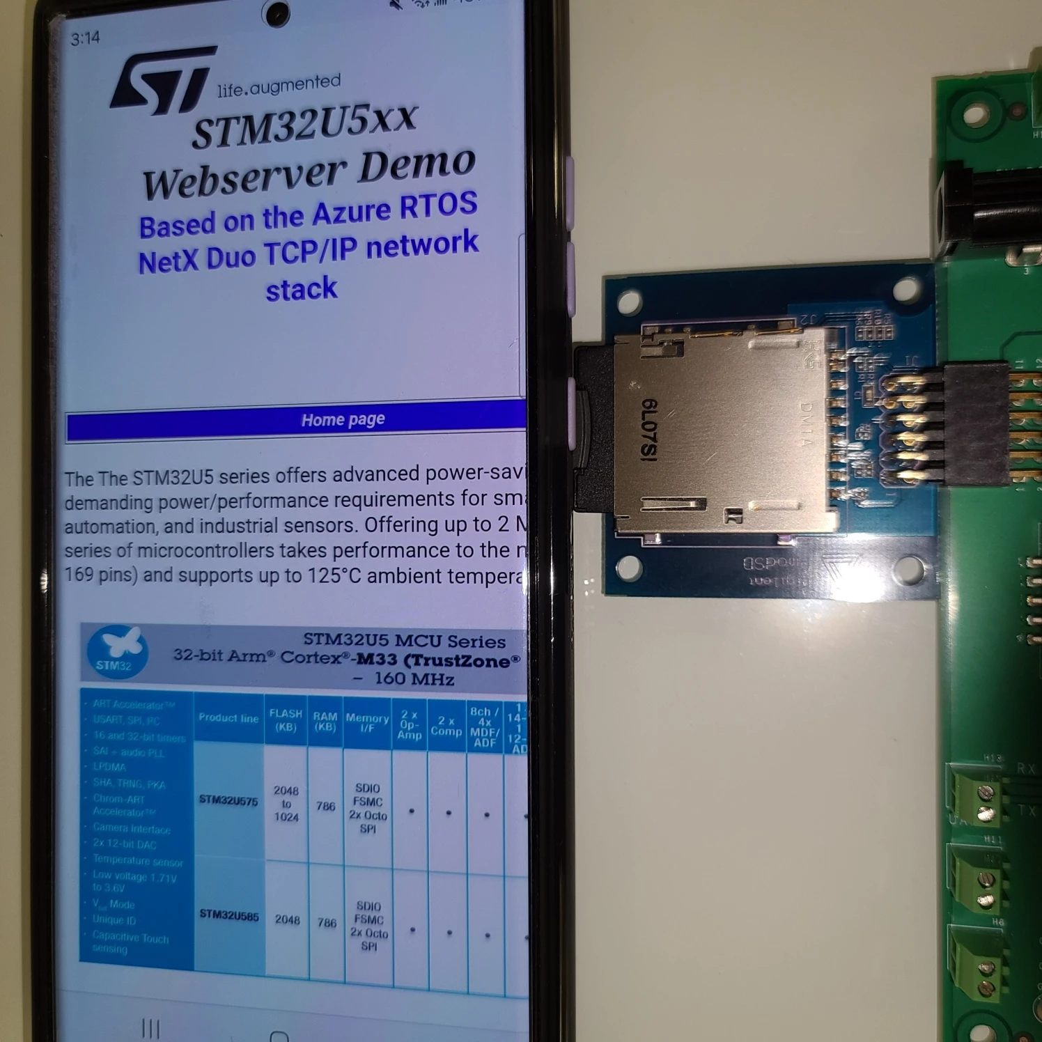

Just: my SD Card interface or the SD Card seems to have a problem: the file system, to initialize and to open the request files (e.g. "index.html") does not work.
But the USB EMC is working! Cool
When I connect via USB-C to Android phone, enable "Ethernet tethering" - the MCU progresses, gets an IP address (via DHCP server) - cool.
I can also "ping" the MCU, via the IP address on UART log (ping tool on Android phone, I cannot reach MCU from PC: a different network, potentially a "route" setting needed, with a gateway to reach the other network)

Issue with SD Card solved:
The flying wires were causing the issue to open the web files. With a carrier board where SD Card adapter is connected - all works fine. BTW: I tried to lower SDMMC speed, clock dividers - nothing helped really, except to make the connection "directly" for SD Card adapter (I got CRC errors on SDMMC transactions).

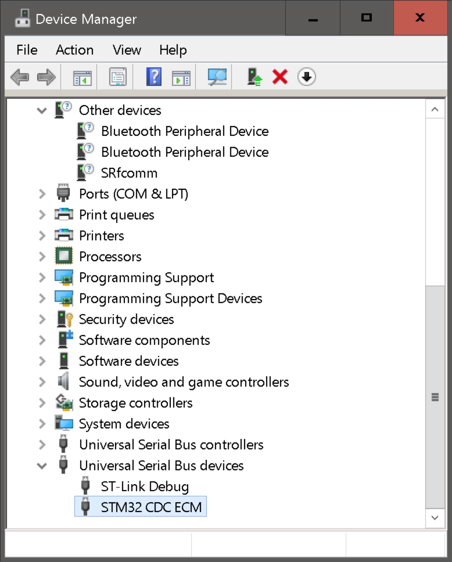

With STM32H735G-DK, I had modified the example project to use static IP instead and just used Ethernet setting on phone in static IP mode. No need to look for IP address on console.
Great that you found a CDC-ECM driver too for Windows. Very useful.

For anyone coming here due to interest in ethernet/IP over USB, I'll note that TinyUSB has support for ECM, RNDIS, and recently added an NCM impl as well. Their maturity varies,  but at least there's active development around it.
Windows 11 ships with a microsoft driver for usb NCM devices.
