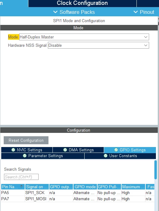

On my last question, I realize it's not maybe so clear. So let me be more precise on this. Here is how I plan to assign pins:
  • Display #1: Rotary 1.3" display (SPI interface, 240x240. IC GC9A01N). Connected to:
    • STM32's SPI3-MOSI
    • STM32's SPI3-SCK
    • STM32's general GPIOs for Chip Select and D/C Select
  • Display #2: Same type Rotary 1.3" display (SPI interface, 240x240. IC GC9A01N). Connected to:
    • STM32's SPI1-MOSI
    • STM32's SPI1-SCK
As you see, the other pins from the SPI3 and SPI1 (MISO, RDY, NSS) are not utilized. My question is: are those unused pins (SPI3-MISO, SPI3-RDY, etc....) available for other different I/O applications, (relay driving, etc...), or the fact that I 'enabled' SPI1 and SPI3 is forcing those SPI3-MISO, SPI3-RDY, ... pins to be dedicated to the SPI application only ?
Thank you very much again !
MM..1
Jun 9, 2025 11:11 AM UTC
If you create in MX simple check on GPIO part for peripheral how pins is used, other is free ta any purpose.
