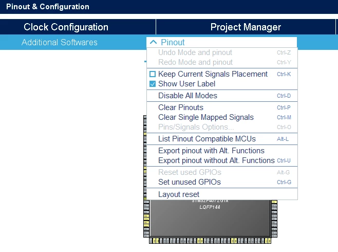

I am using a STM32U5G9VJT6Q and need the Altium symbol. Because it is a relatively large IC I would rather copy-paste the names and pin numbers pairs to avoid any errors (not out of laziness), but:
- if I copy and paste the pin names (or any other data) from the PDF datasheet, when I paste them they all paste as a the same character: a question mark inside a square box
- I tried downloading it from the STM32 page but most of the time it does not generate the symbol (I tried multiple browsers and multiple computer but it just does not download them). When it finally downloaded, it actually generates a script and the script generates the wrong pinout. For example pins 6 and 12 (for the LQFP-100 with DSI) should beVDD11DSI but the generated symbol sets them as OSCI and VBAT... And the same for other pins...
I attach a csv file generated from the STM32CubeMX => Pinout => Export pinout :

If you create the symbol/footprint with Ultralibrarian, there is a "Model Feedback" button.
