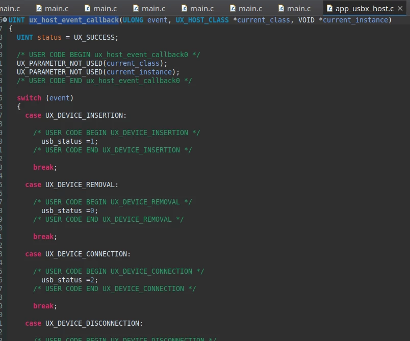

AScha.3
May 24, 2025 4:16 PM UTC
in USB event loop you can see it -> i set a global info then, usb IN or not...
