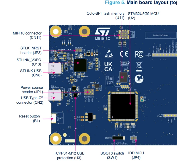

For some reason, an interrupt isn't being triggered when I connect the USB to my stm32 board, and the reason is baffling to me. I have attached the relevant excerpt of my code

AScha.3
AScha.3Best answer
August 20, 2025
Aaa, now i understand (i dont have/tried U5G9 :( there is no (old) USB by STM .
So you have to copy/install it yourself, or try it with the USBX (from Azure):
there you can choose, which kind of USB device you want.
read
https://community.st.com/t5/stm32-mcus/how-to-implement-usbx-in-standalone-mode/ta-p/614435
and board is ? STM32U5G9J-DK2 ?
What did you with the board ? made program...flash..?
Connect to which USB ?
CN8 is for connect/debug .
Maaz1Author
August 15, 2025
I did it to CN2
STM32U5G9J-DK2
flashed my board with stm32cubeprogrammer
