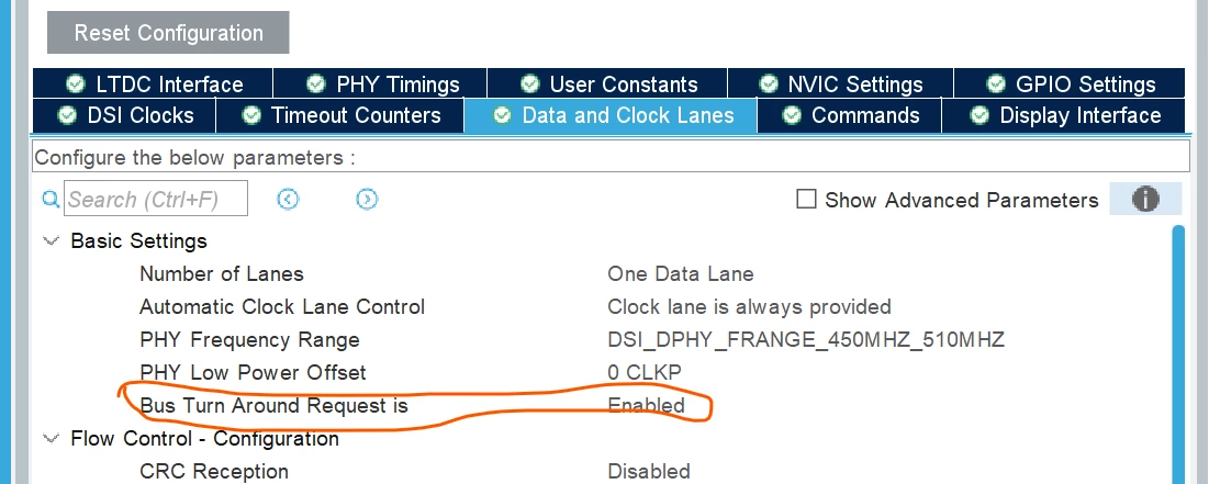

DK1 interface a one lane DSI display. DSI display is using SH8601A LCD driver.  SH8601A only can be initialized in LP mode, not HS mode. In Mx, DSIHOST configuration,
1.  Bus Turn Around Request is enabled
2.  Transmission commands in LP mode is configured
3. After start DSI, I try to read  the display, it returned TIMEOUT error.

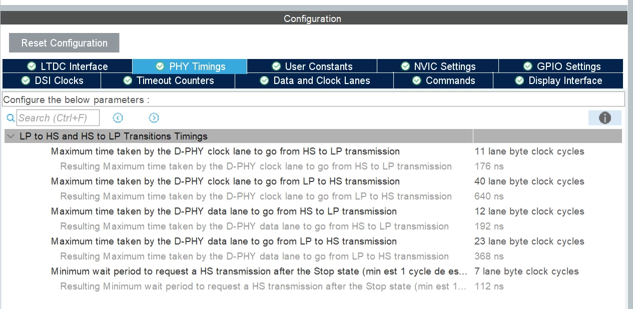

In PHY timing,
The HS and LP means which status,  HS means HS 0 or HS 1? LP means LP11, LP01 or LP00?  The read failure might relate to wrong timing configure.

Please help on how to calculate these values using MIPI parameters according to display module  Tclk-miss, Tclk_post, Tclk_Pre, Tclk_Prepare, Tclk_settle, Tclk_Trail, Tclk_zero, Teot,   THS_prepare, Ths_Exit, Ths_ zero, Ths_settle, Ths_skip, Ths_trail, etc. Thank you.

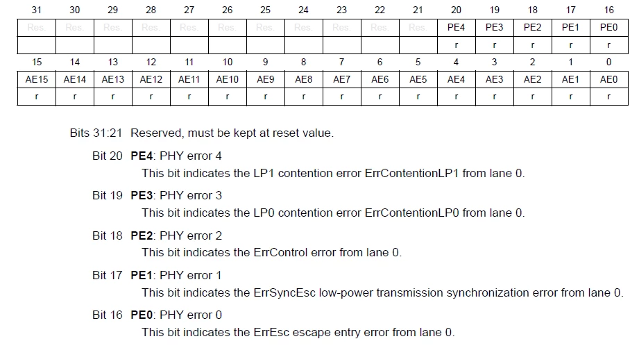

Could you please check the PE5 bit status in DSI_ISR0 register?
This bit retrieves the peripheral timeout error from the acknowledge error report.

For timing values, I recommend you to look at the DS14102 Rev 3 Table 127. MIPI D-PHY AC characteristics LP mode and HS/LP transitions

DSI_ISR0 register value is 0x10 0000. Which means PE3 error. AE5 is fine.
DSI_GPSR register is: 0X4 0055 . i.e. command FIFO and read/write payload FIFO are empty。
I noticed the mipi timing in data sheet.
I just don't understand the timing definition in STM32CubeMX.
For example :
in DSIHOST, PHY Timing
                        LP to HS transition = THS_Prepare,from LP00 to HS-0,
                   or   LP to HS transition = THS_Prepare + THS_zero,from LP00 to end of HS-1?

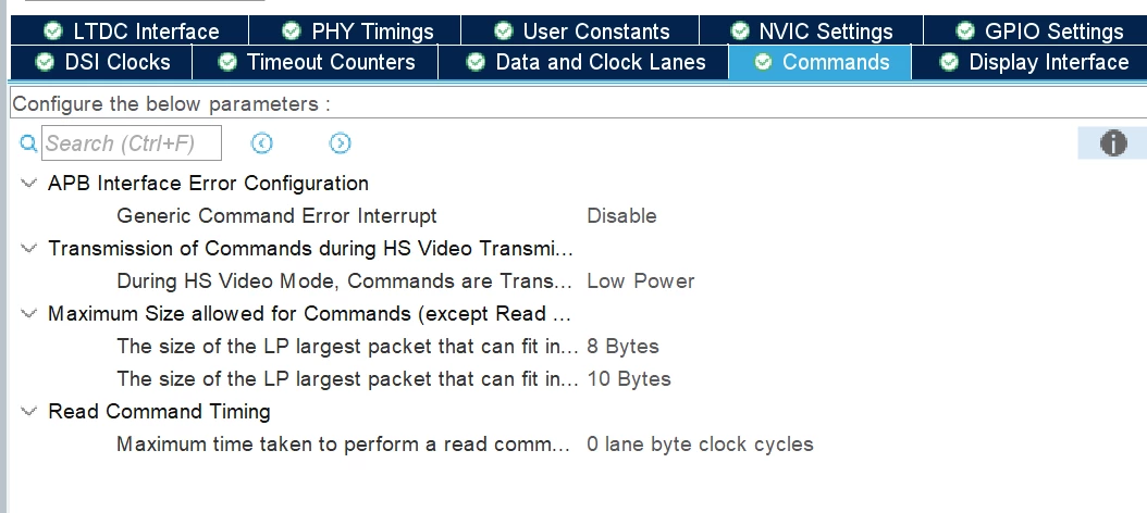

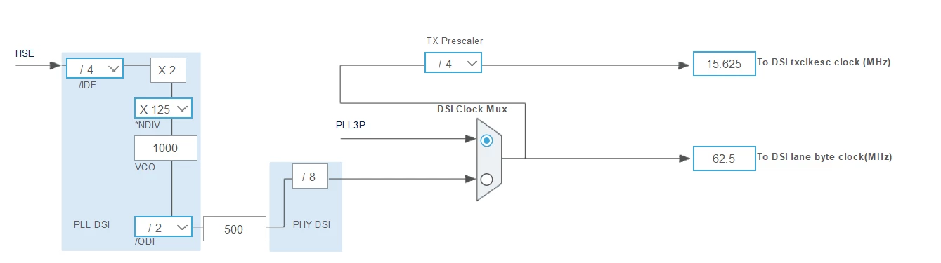

If transfer configuration command to display through MIPI in LP mode while DSIHOST is configured to video burst mode,MIPI LP clock will be 15.625MHz as indicated in screenshot below,right?Or LP byte clock is 15.625MHz,LP clock is 15.625*8 = 125MHz?
