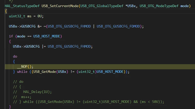

recently, I am eager to deal with my scratch build STM32U5A9's USB HS Host.
I compiled STM32CubeMX generated  USBX host code and tried it.
but didn't work at all.  even first USB device connect detection interrupt didn't occur.
After so many times of debug, i finally noticed that set after FHMOD bit in GUSBCFG, CMOD bit in GINTSTS remain zero eternity.
CMOD bit is supposed to be 1 in forced host mode.
I tried to see if escape above image do loop. but, loop forever.
USB_GetMode(USBx) refers to GINTSTS register and USB_HOST_MODE means 1.
is this Errata?
