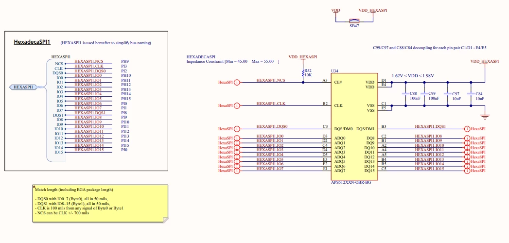

Do you use the same STM32U5A9J-DK Altium_Designer project ?
Do you use the same line length and thickness as in the STM32U5A9J-DK Altium_Designer project to connect the PSRAM?
Could you please check the PSRAM pins?
Thank you.
Kaouthar

Thank you for your response. I went over our PCB with our hardware engineer. Our lines are all within 10mil of eachother so we're well below the 50mil requirement. What does byte0 and byte1 mean here though? Our clock is less than 100mils away from our data lines, but by looking at your stm32u5a9j-dk board your clock line also doesn't seem to be further than 100mil from data lines. So if byte0/byte1 aren't data lines what are they referring to?
We are not using your altium designer project because we use kiCAD but we've checked the psram pins against your schematic several times.
Please let me know what else you need from me.

Hi @nwm_35 ,
Byte0: DQS0, IO0, IO1,..,IO7 signals, these lines are match length with a maximum tolerance of 50mils.
Byte1: DQS1, IO8,..,I15 signals, these lines are match length with a maximum tolerance of 50mils.
CLK  is 100 mils from any signal (DQS0, IO0, IO1,..,IO7, DQS1, IO8,..,I15).
Could you please try to decrease the HSPI frequency and let me know if the PSRAM issue is solved or not?

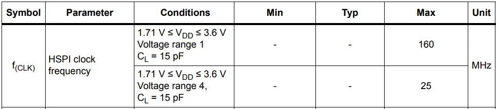

I'm now running the hspi ram at 208 mhz, the maximum that appears to be supported by the stm32u5 and no prescaler. There is still this screen tearing issue, only on transitions. The length of time that the tearing occurs is cut down by increasing the hspi clock, but we still have over a second of static on screen transitions. I am using variable latency, 16 byte linear bursts, and my IO mode is set to X16 mode.
Are there any strategies still to try or should I be concluding that this hardware does not support driving a screen of this resolution?

Hello @nwm_35 ,
The HSPI interface can reach 160MHz as mentioned in the datasheet.
For the screen issue, I advise you to check the LCD timing configuration.
Please take a look at AN4861 may help you.
Kaouthar

Hello @nwm_35 ,
As I mentioned in my last comment the maximum frequency guaranteed is 160MHz as cited in the datasheet.
For the animation issue, could you please try storing the frame buffer to an internal memory.
If, the animation issue isn't solved, I advise you to create a new dedicated post for this behavior or to contact your FAE.
