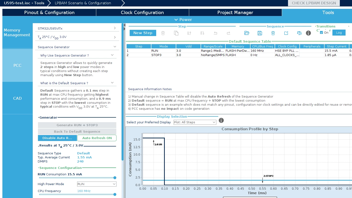

AScha.3
May 20, 2024
in IDE/CubeMx is also a power calculator: set what you want and make a some ms step - then you see...
-> New Step -> then set your peripherals , that you use ...

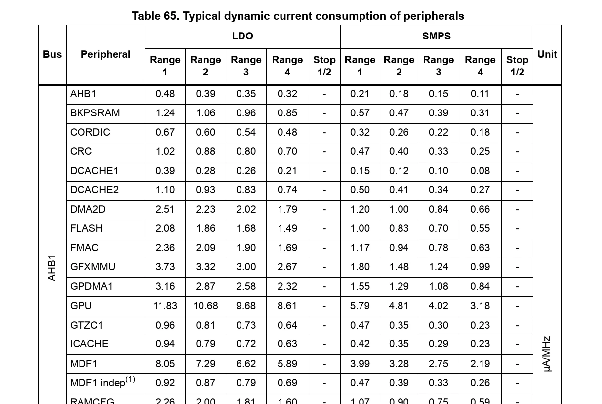

May 20, 2024
So look in ds and add all together + cpu ... but why not using Cube ? Too easy ?
see ds ...4 pages !!!!
