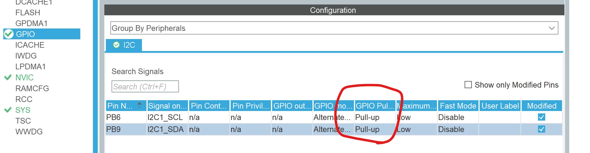

You can use the internal ~40 kOhm pullup resistors with reduced I2C clock rate, maybe 10 kHz, and it'll work just fine.
I'd put a scope on SDA/SCL to verify edges are sufficiently fast for the clock rate you choose.
It's not ideal because your bus will be floating before the pins are initialized, but this will likely not be a problem. If it is and slaves are holding SDA low, SCL can be toggled to free up slaves.

This post makes no sense. AI slop? Just not reading?
This is what you asked (again)
> Can pull-ups be enabled via STM32CubeIDE or firmware?
The answer is still yes.

As TDK has pointed out, You can enable the internal week pullup (worst case is 50K Ohm) this is about 10 times the resistor value normaly used on I2C. So this is only a work around for the prototype (You have to modify the schematics / PCB for a stable product), and requires that You reduce the I2C clock!
