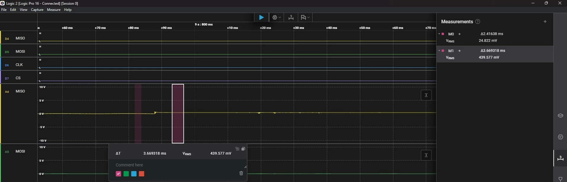

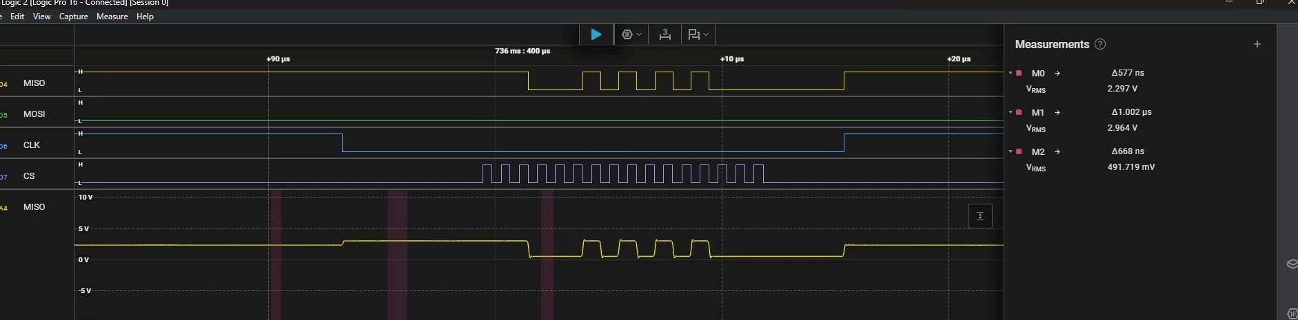

When SPI1 is enabled and PA11 is configured as MISO, the pin appears to load the signal unexpectedly.
In our setup, the external SPI device drives the MISO line push-pull. However, the signal level reaches only about 2.9 V when active. When the SPI device is inactive (CS de-asserted), the signal drops only to about 2.3 V.
To exclude the external SPI device as the root cause, we disconnected it completely and performed a simple GPIO test:

- PA11 voltage only slightly above 400 mV
This behavior suggests that PA11 is being internally loaded by the MCU.
Measurements and screenshots:
MISO connected to 3V3 with 10k resistor
MISO connected to SPI device

- The issue was reproduced with different external SPI devices.
- Some SPI devices are no longer able to drive the MISO signal to a valid logic-high level when connected to PA11.
- Communication errors can occur as a result.

eliasgruberBest answer
Aug 27, 2026 8:09 AM UTC
We solved the issue. In the reference manual chapter 10.7.12 USB power management in low-power modes
(STM32U59x/5Ax/5Fx/5Gx only) there is a paragraph “Using PA11 and PA12 GPIOs” where it is written that the usb powerdomain has to be enabled to use this pins. There also is a hint in the GPIO chapter under “13.3.16 Using PA11 and PA12 as GPIOs (STM32U59x/5Ax/5Fx/5Gx only)” which we did not recognize.

Aug 27, 2026 8:06 AM UTC
USB was completely disabled. However, we overlooked the fact that the USB power domain must be enabled before PA11 and PA12 can be used as standard GPIOs.
eliasgruberAuthorBest answer
