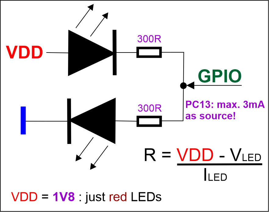

Three states on a single GPIO pin with two LEDs is possible.
For users who want to drive 2 LEDs with three states with one signal GPIO - please, see the details below.

One GPIO pin for three states
  • Use a Dual-LED with two LEDs, "anti-parallel"
  • One LED is on, if GPIO is set low (acting as a sink)
  • The other LED is on, if GPIO is set high (providing a source)
  • Both LEDs are off, if GPIO is configured as an input (no current)
Remark:
if you run VDD as 1V8 (as I do) - you can only use red LEDs! The forward voltage of a green LED (or a blue one) is above 1V8 - it would never go on.  With 3V3 you can use any combination of colors (maybe not white).

Yes, I know: datasheet says: PC13,,,PC15 can just source 3mA in total (as sum). And it should not be used to drive LEDs (directly), even I do.
But I made sure the current is below 1mA (1V8 with 300R).
I decided to use PC13 as LED because it does not have any other useful ALT function (e.g. SPI, I2C, ...).

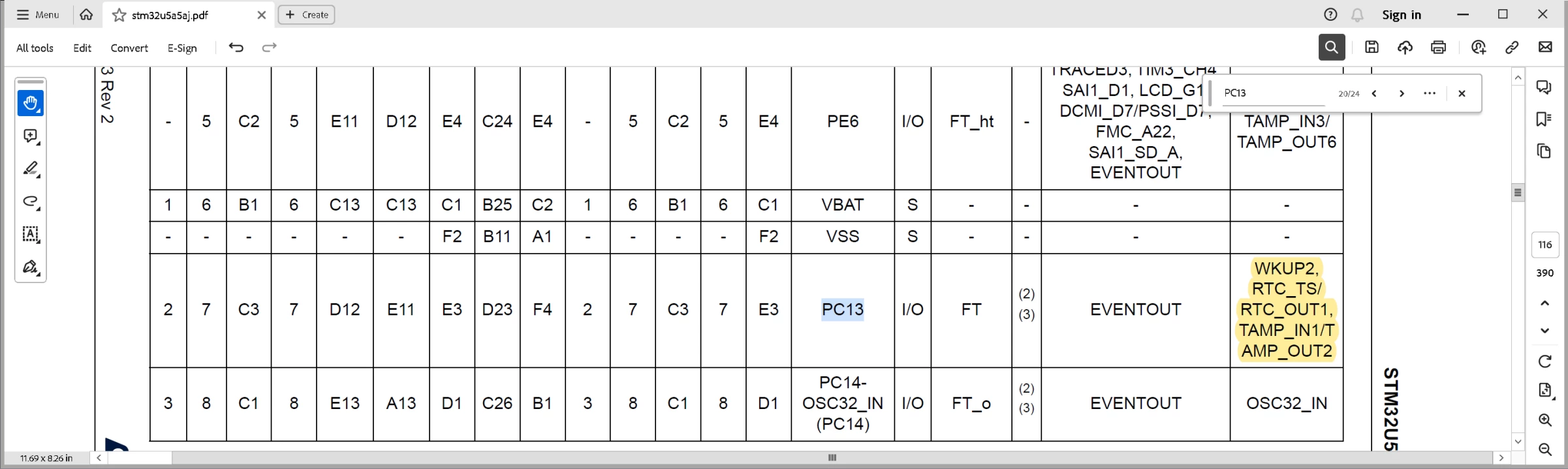

Here the functions for PC13.
How to configure/enable the "additional functions"? (only EVENTOUT is possible for me)
Is one of the "additional functions" enabled when a FW was never flushed?

> how to configure PC13 for RTC_OUT1? I have not found an ALT setting to do so?
See Table 628. RTC pin PC13 configuration(1) in the reference manual for how PC13 is configured for RTC options. It is in "Additional functions" because it is not defined as an "alternate function" through the normal means (GPIO_AFRx registers). It is controlled with the RTC registers.
By default, it should be a GPIO pin as far as I can see. Analog mode, high impedance.
Can definitely light up an LED with less than 1.8 V, though I'd be surprised if it was visible at 0.9 V.
Should be able to connect to a virgin chip and examine register values to determine the configuration when it's in the unknown state.

Thank you, makes sense (to have PC13 as RTC pins, when configuring RTC).
I run board with 1V8 (not 0.9V, too low anyway).
I try to debug a virgin chip, no FW loaded: just to see how to do... (with ST-Link debugger, esp. how to see registers when MCU FW should not be flashed, starting debugger from IDE flashes FW first - very delicate).
