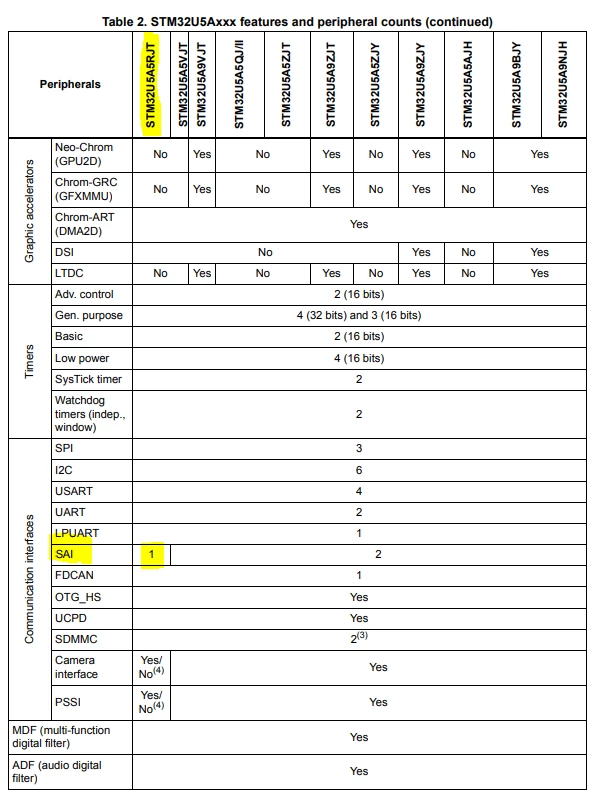

KDJEM.1
March 21, 2024
Hello @tjaekel ,
Thank you for this feedback. The STM32U5A5RJT6Q (LQFP64) have one SAI as mentioned in the datasheet table 2 based on that it didn’t have an SAI2.
The "STM32U5Axxx pin/ball definitions (1)" table  covers all IP available on that pin regardless of package. The customer should be referred to availability of IP on his product package. This behavior is explained by this note:
"1. Function availability depends on the chosen device."
Thanks and best regards,

tjaekelAuthorBest answer
Lead II
March 21, 2024
Thank you.
I have not seen table 2 (telling me just one SAI) - OK, got it.
But the pin/ball definitions give me the conclusion, that available pins would even support SAI2.
Just curios:
How is your pad ring working? If a pin is not connected/populated (because of a smaller package) then it is obvious that this function (ALT) is not available.
But if there is PB15 and the pinmux table lists also as SAI2_SD_A - how is just the SAI2_SD_A feature "removed"?
Do you have bonding options on the padring, an internal bump to enable/disable SAI2? (maybe, SAI2 might be still there but powered down internally).
"Hmmmm": so I have to change to a LQFP100 package (just for this "missing" SAI2).

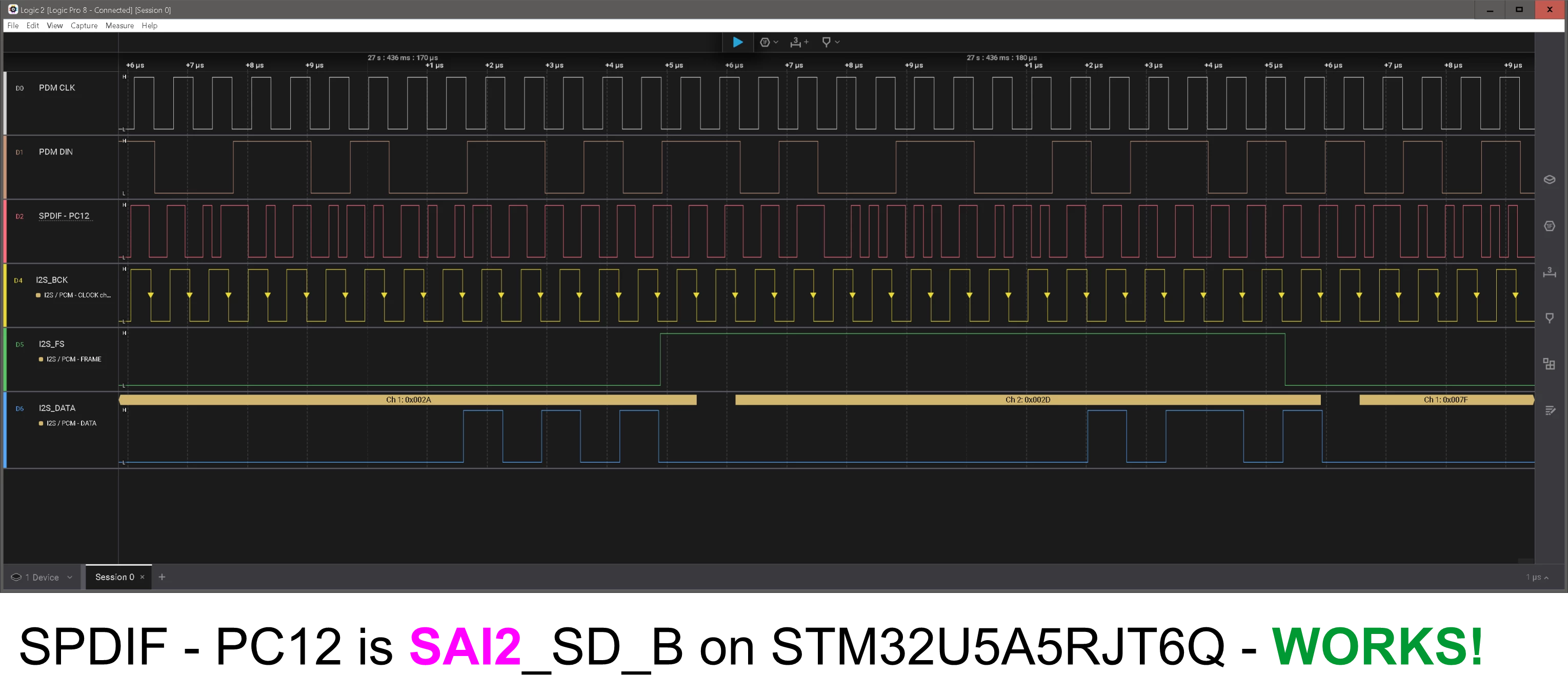

tjaekelAuthor
Lead II
March 21, 2024
I think: the STM32U5A5 datasheet is wrong:
  • I can configure PC12 on a LQFP64 package (STM32U5A5RJT6Q) as SAI2_SD_B (for S/PDIF)
  • I see the signal coming out
So, the statement that STM32U5A5RJT6Q has just one SAI1 does not seem to be true:
SAI2 works as well!

KDJEM.1
March 28, 2024
Hi @tjaekel ,
Thank you for you feedback.
Even if SAI2_SD_B and SAI2_SD_A work, but they are not guaranteed to be functional since they aren’t tested in production.
Thank you.
Kaouthar
tjaekelAuthor
Lead II
March 28, 2024
Thank you.
I saw it working once (but with a lot of audio artefacts). Now, I cannot replicate anymore: even I see the SPDIF signal coming out - I cannot receive it. I might need a SPDIF decoder on scope (or another STM board with SPDIF RX, just to figure out what is wrong, via checking Rx status and data). I assume, the clock config is not yet correct or the handling of the CS, U, V bits.
When you say "not tested": I understand that datasheet says for STM32U5A5 LQFP64 package just one SAI1, not SAI2 (even some pins for SAI2 are there). But the LQFP100 has support for both SAIs. Why SAI2 should not be tested? If it works for LQFP100 package - then it should work also on LQFP64 package, shouldn't it?
Maybe, I try SAI2_A as I2S, the pins are there (PB13, PB15, PC0). For SAI2_B, the SAI2_FS_B is missing on LQFP64.
