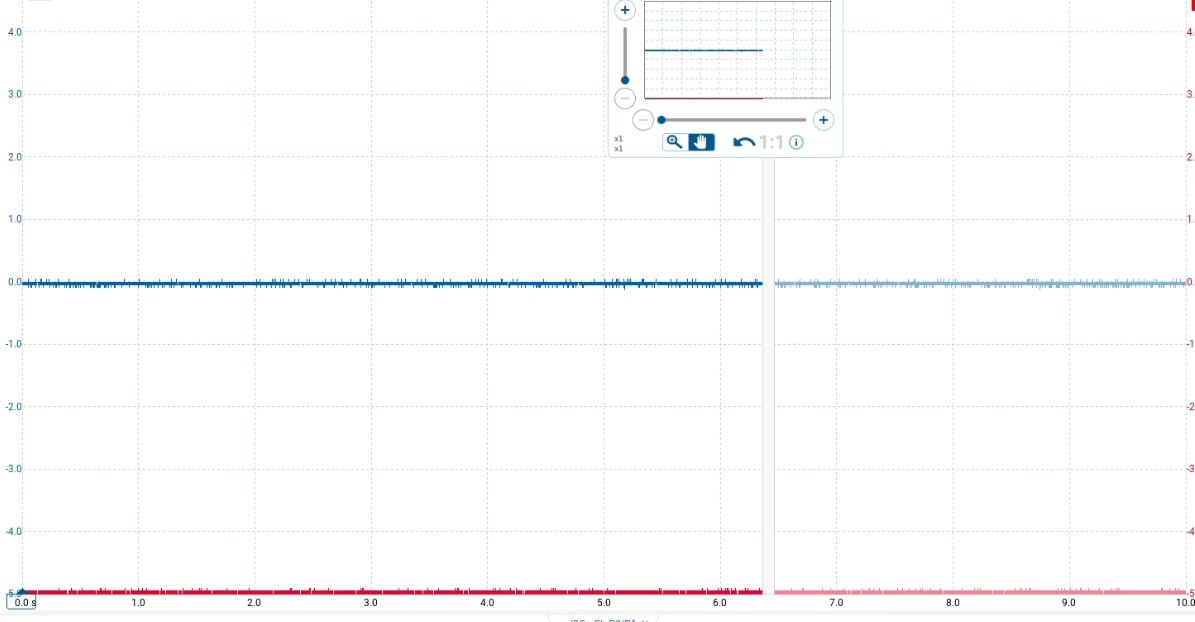

I have recreated new project using cube IMX and use I2C2 PF0 and PF1 but not getting any output , I have been using picoscope to see it
ahsankAuthor
Feb 8, 2024 3:28 PM UTC

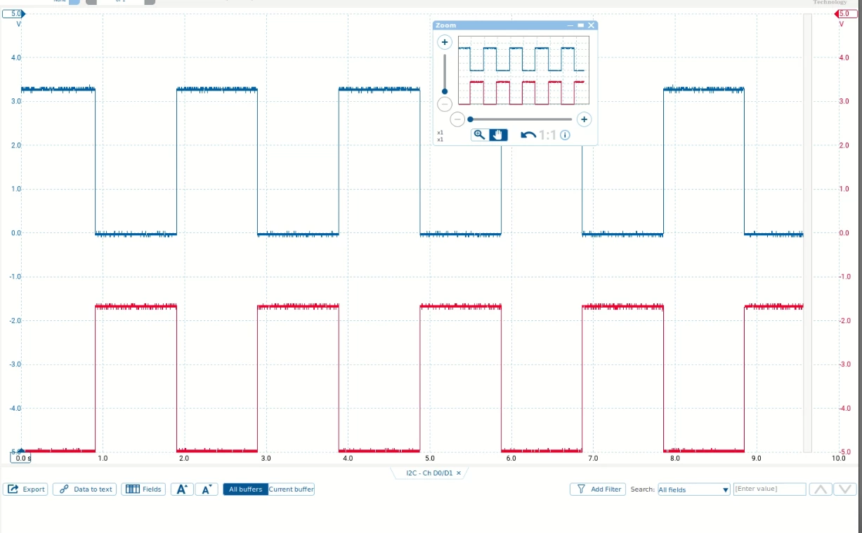

if i just toggle PF0 and PF1 I am getting correct output but If I send data using i2c using following main while loop and obv configuration done by cube IMX

I am not getting proper output like this
@TDK  @Rushali

What board is this?
Do you have pullups on SDA/SCL lines? If so what values?
What waveform do you see on SDA/SCL during a HAL_I2C_IsDeviceReady call?
