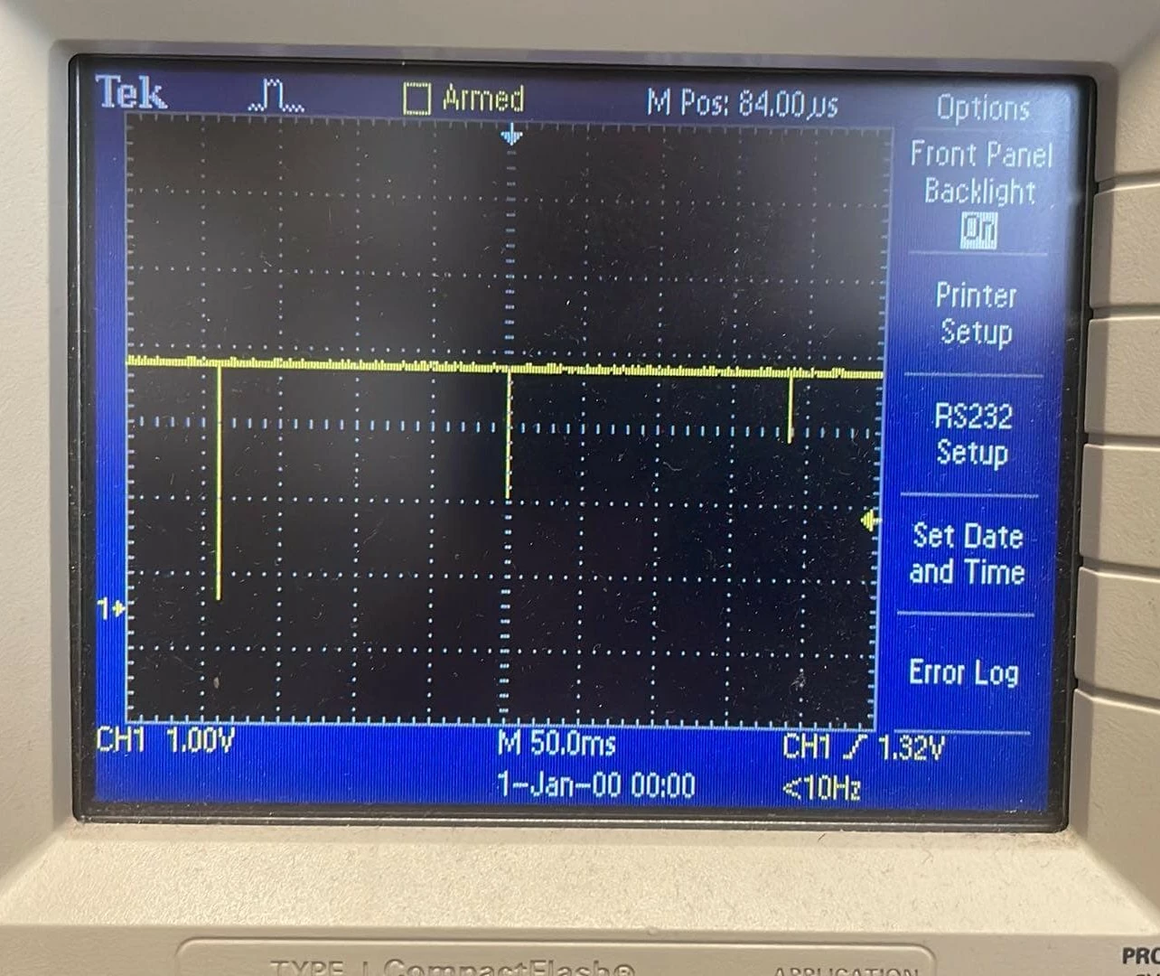

I am facing an issue while trying to enter the STM32 bootloader via USART1 on an STM32U599ZJT.
Issue:
When applying 3.3V to BOOT0 and performing a single reset, the MCU enters a reset (boot?) loop, which persists until BOOT0 is deasserted.
Test Case:
  1. BOOT0 → 3.3V

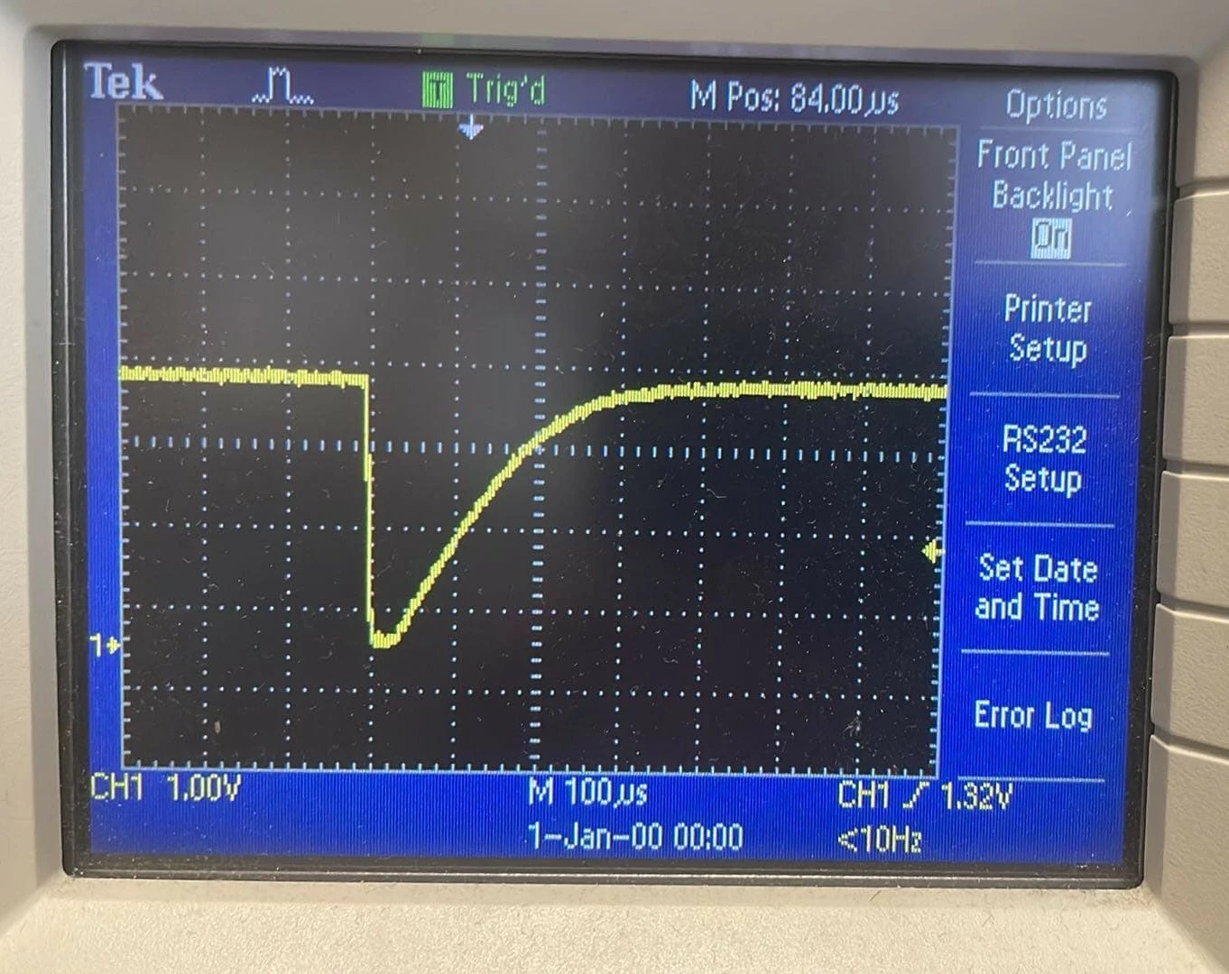

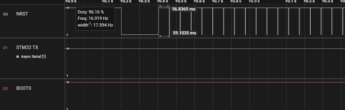

  2. NRST pulled to GND once (manual reset)
  3. MCU stuck in a reset loop (observed reset pulses on NRST, ~50-120 ms period)
However, when BOOT0 → GND, the reset loop stops, and the MCU behaves normally.

Feb 13, 2025 7:49 PM UTC
The USB_DM pin (PA12) must be pulled high with a strong pull-up resistor (maximum 2.7kΩ).
