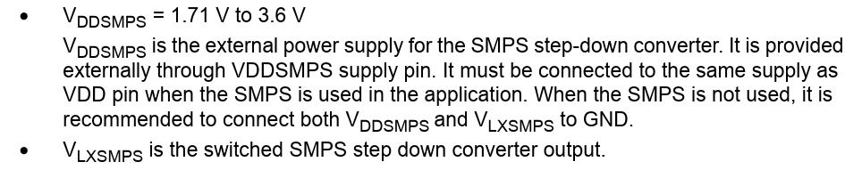

I am using STM32U599VIT6Q for my project and I am unable to flash the MCU. When I turn on the board it consumes 50mA. Also, I am not using SMPS so I have connected the pins (VDDSMPS, VDDLXSPS, VDD11, and VSSSMPS) to the GND. Whenever I try to run the code it says cannot connect to the device.

Are SMPS pins a problem? Are they must use for this MCU?
Could you please help me with what could be a problem?

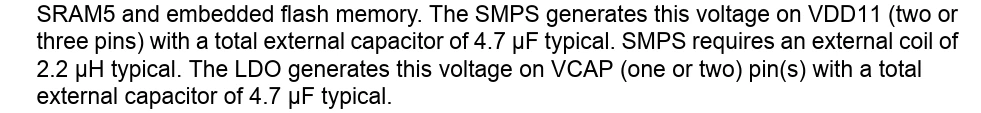

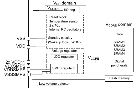

1. why you buy a cpu with smps, when not using it ? (-Q version) You should use STM32U599VIT6 (no smps).
2. the core supply VDD11 - you short to gnd !   (no core - no fun !  You know ?  :)   )
If chip still alive - lucky !
all this from rm ; read rm can be useful some time -->
So put 2 x 2u2 cer.caps on vdd11 pins - and you see: cpu still alive , or buy new. (Then this time w/o smps...)
And connect Vbat to VDD 3v3 , if you have no battery there. (nc is not allowed.)

May 5, 2024
NNOOOO !
VDD11 pin --- 2u2 ---- gnd .  (here the internal core voltage coming out - need cap to gnd . )
( 2x if 2 pins .)
