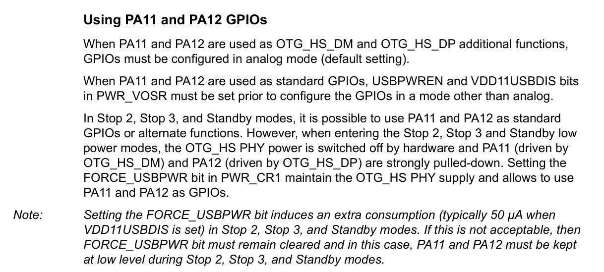

Hi,I used PA12 & PA11 as input gpios(pull-up) in STM32U595VJT6Q ,read the pins are always '0'.The IOs connected NOTHING.
I reference RM0456 :
I config USBPWREN and VDD11USBDIS bits used the HAL functions before  GPIO_Init():
HAL_PWREx_EnableUSBHSTranceiverSupply();
HAL_PWREx_DisableVDD11USB();
BUT I read the pins still '0'.How can i do?

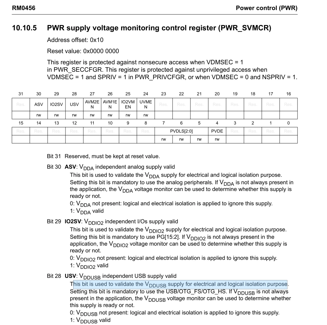

ElatewendyBest answer
Apr 11, 2024 3:45 AM UTC
Thanks @SStor
Solved: Problem with Pin A11 on STM32U595VJ - STMicroelectronics Community
This method is effective.
SET_BIT(PWR->SVMCR, PWR_SVMCR_USV);
SET_BIT(PWR->VOSR, PWR_VOSR_USBPWREN | PWR_VOSR_VDD11USBDIS);

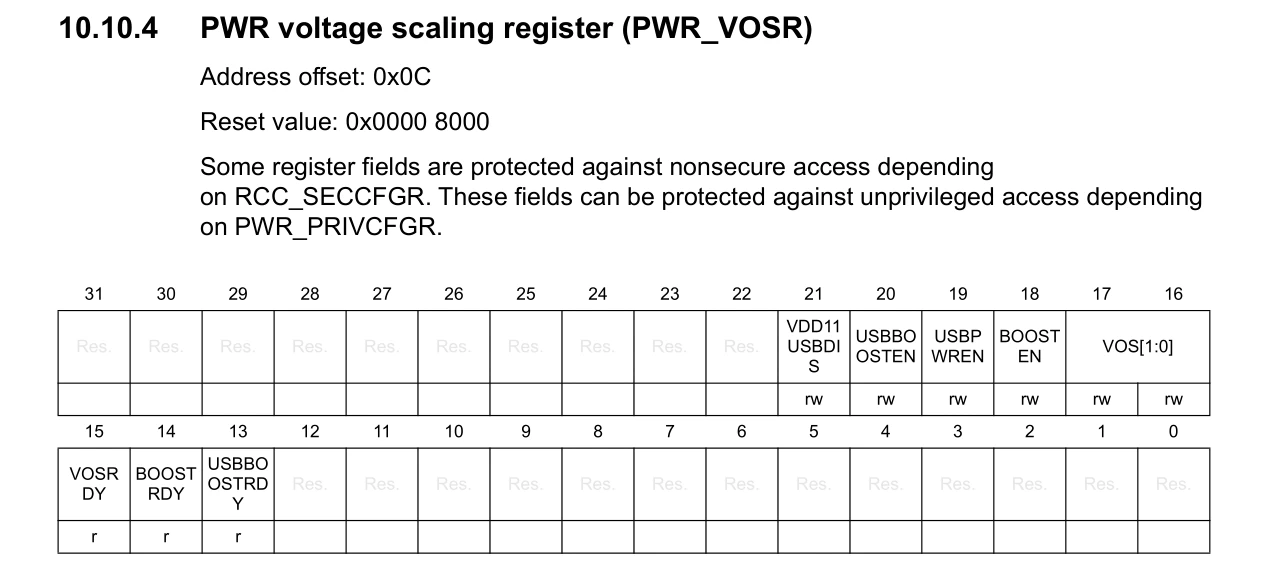

waclawek.jan
Feb 5, 2024 12:00 PM UTC
Read out PWR_VOSR content and check those two bits in it. If they are not set, check if you've enabled clock for PWR in RCC.
If that's OK, read out and check GPIO registers content.
Feb 6, 2024 6:35 AM UTC
Thanks for your reply.I made a mini project to read the registers.The GPIOA register are ZERO...
The result like as:
HW VERSION 001001
reg_pwr_init = 0x7c000
reg_pwr = 0x2fc000
reg_gpioa = 0x6700

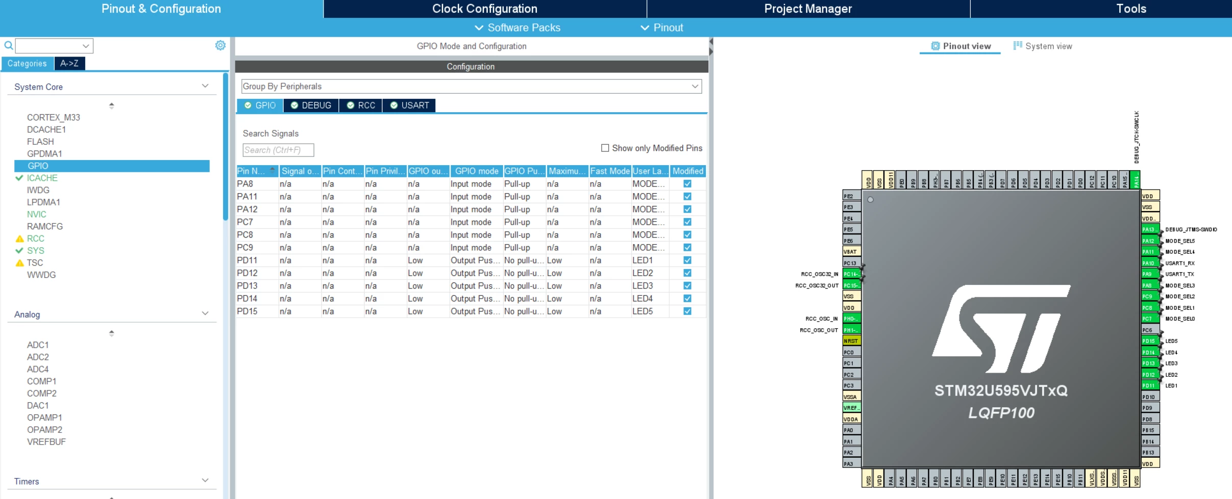

Feb 7, 2024 6:20 AM UTC
Hi,my project is created by CubeMx.
The GPIO configured like as:
ElatewendyAuthorBest answer

waclawek.jan
Apr 11, 2024 6:26 AM UTC
Oh, an isolation switch... Thanks with coming back with the solution.
