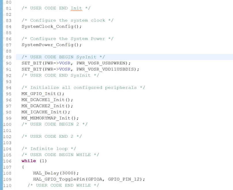

I used PA11 and PA12 as standard GPIO in STM32U595ZJT6Q and system frequency is 4MHz. Config PA11 and PA12 to PP output mode ,no pull up.Don't set this gpios to high, the mini system current is 3mA,but set this gpios to high, the current is 22mA.
Test PA10 or PA0,this current no changed.
I reference RM0456 rev4  13.3.16  and 10.7.12 ,used PA11 and PA12 as standard GPIOS,the USBPWREN and VDD11USBDIS bits in PWR_VOSR must be set.
I config these bit before config GPIO, but this current no changed,still is 22mA.

Did you tried to set FORCE_USBPWR bit in PWR_CR1? Does it have any impact?
Are you using your own board or an ST board?
-Amel

Hi @Amel NASRI ,
I will tried to set FORCE_USBPWR bit in PWR_CR1 tomorrow.
I have U599 EV board.
I tried U599 EV board too, but its current  also is 22mA . Too bigger.Using other gpio , it's right, only PA11 and PA12.

Hi @Amel NASRI ,
I dont used low power mode.
SunwazAuthor
November 9, 2023
Hi @Amel NASRI ,
I set FORCE_USBPWR bit in PWR_CR1,the current  smaller from 22mA to 15mA.But its to bigger.

Could you please tell me the REV_ID of the devices you used for test (0xE004 4000)?
-Amel
SunwazAuthor
November 10, 2023
This picture is the MCU message read by STM32CubeProgram.
SunwazAuthor
November 13, 2023
The value is 0X30016481 @0xE004 4000.
