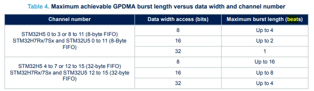

Based on this table from AN5593, the maximum burst length depends on GPDMA used channel and data width:

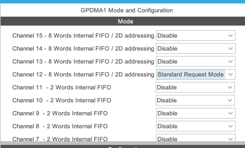

In STM32CubeMX interface, Data Width & Burst Length are parameters that you can configure once you select the channels to use, on channel dedicated tab.
