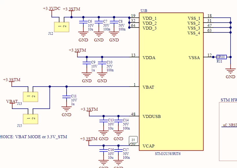

STM32U585RIT6 - Power supply the MCU at 3.3V act as a shortcircuit
Hello all,
I developed a board based on the STM32U585RIT6 (without SMPS package) based on the STM32U5 guidelines.
I've encountered a problem during tests: When I turn on the MCU block on my board, the MCU draws >600mA of current.

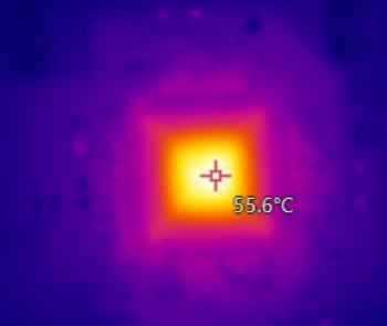

However, I still manage to connect to the MCU with a STLINK. I also used a thermal camera which shows me that the problem is with the MCU.

I didn't have any components around the MCU, so I'm wondering if I'm missing something regarding the power supply.
I read the STM system power management presentation, but nothing was wrong for me.
Anyone have any idea why I can't power this MCU with 3.3V?

VCAP should not be shorted to 3.3V. It should be bypassed to GND with a 4.7uF cap per the guidelines you linked.

October 24, 2023
Thank you, a new view on the situation was helpfull!!

VCAP typically being the output of the internal regulator, with a suitably large bulk capacitance.
Didn't check the U5, but others this pin is notionally 1.2 - 1.25 V
