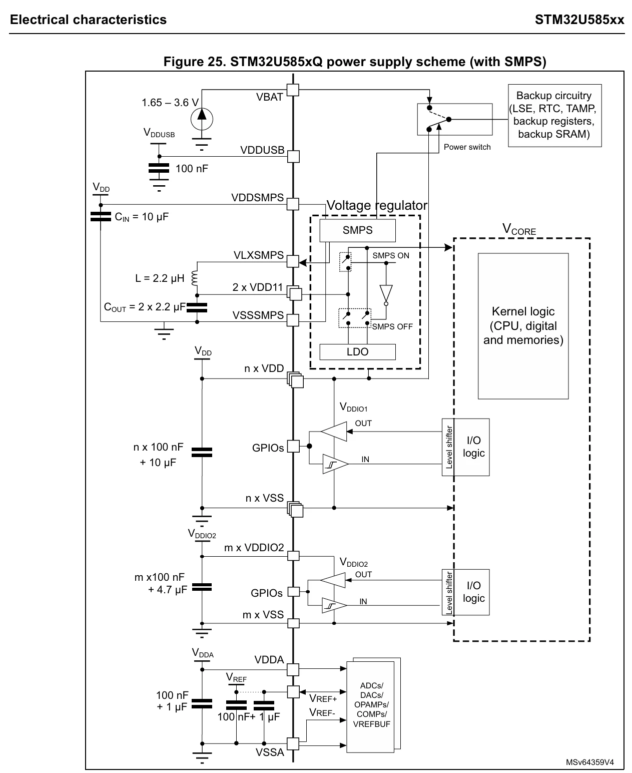

VSSSMPS should be connected to all of the VSS pins.
The datasheet has an example for SMPS connections. Does your design match it? Would be helpful to see a schematic.

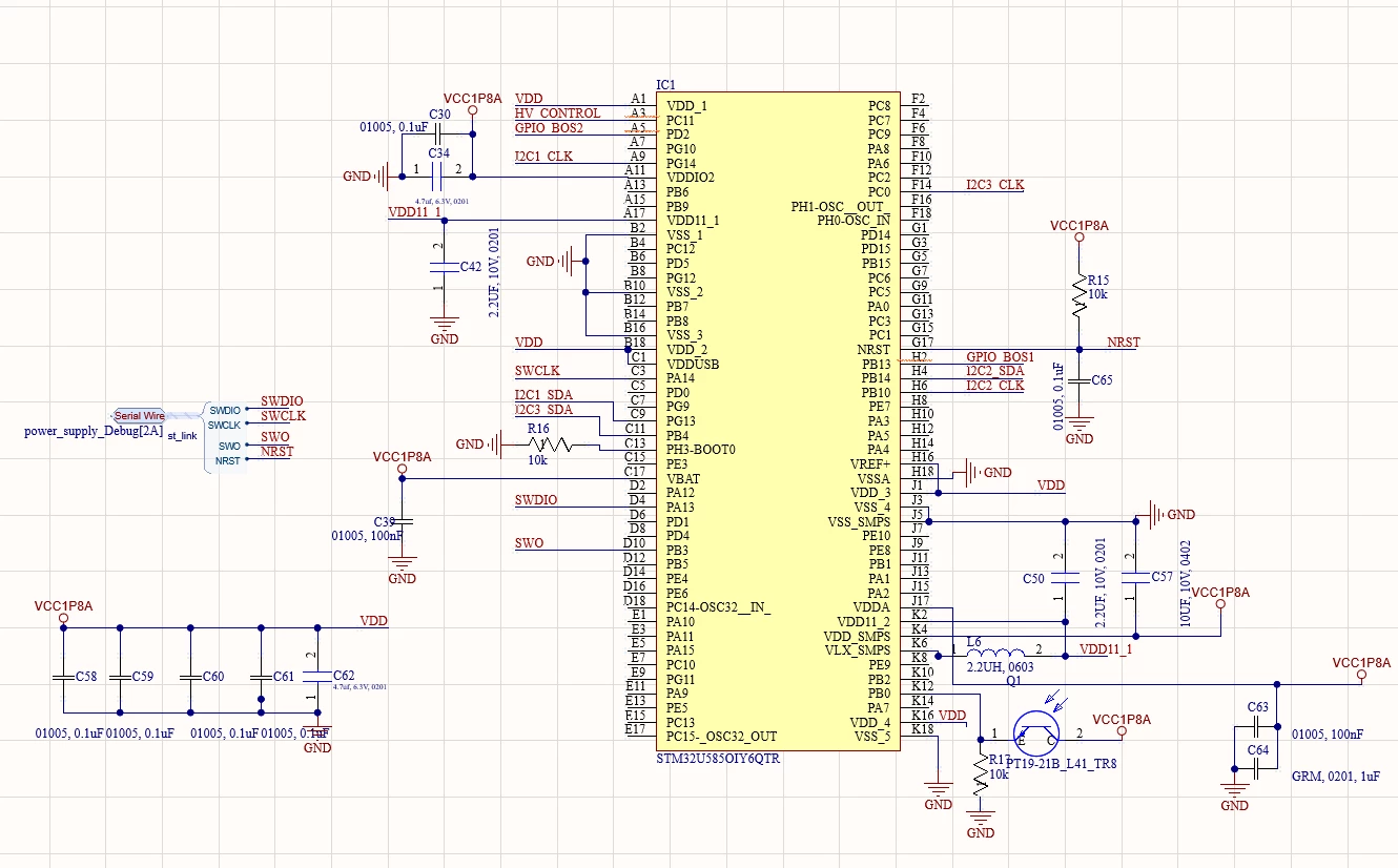

Harry_beeAuthor
Feb 1, 2025 6:39 PM UTC
Hi Guru, thanks for your reply!
I have shared the schematic in the zip folder above and attached it here. Yes, I have connected the vss_smps to all vss. I tried to change the pull-up resistor to at least 1k, but I still can not pull it down when we send out the i2c command. It just does not react. By the way, what could the hardware problem be? Permanent damage on I2C1?
Do you suggest that I try to add some decoupling filters, like 100pf and 0.1uf, for the VDD_smps and VDD11, as the stm32u575 nucleo-144 example did?
And I still could not understand why I connected the VLX_SMPS, VDD_SMPS, and VSS_SMPS to VSS/GND, making the issue even worse, as I2C1 just totally not working anymore.
Best,
Feb 1, 2025 9:29 PM UTC
What is the distinction between VDD and VCC1P8A in your design? If VDD > VCC1P8A, you have some issues:
You hooked up VDDSMPS up to VCC1P8A, but it should probably be connected to VDD.
VDDA is hooked up to VCC1P8A but VREF+ is hooked up to VDD.
I would focus on the power scheme first. Once that matches the schematic, then worry about I2C1. It's possible the chip is already damaged. It's possible there are other issues besides the two above.
