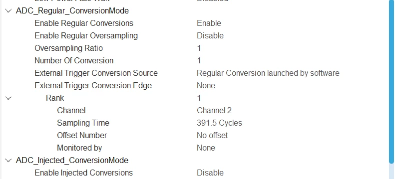

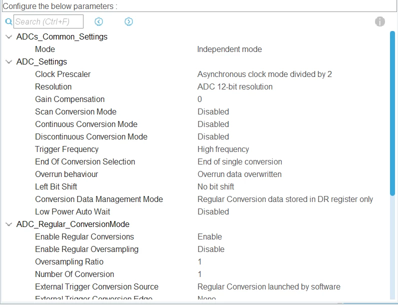

I am planning to do an aging test which need capture the voltage of a net, but i found STM32U585OIY6QTR report a value about 40 while the actual voltage of ADC channel is close to VREF.
Then i write a simple ADC demo to verify ADC configuration, and run my code on B-U585I-IOT02A board(based on STM32U585AII6Q), it report a correct value, but the same code report a wrong value on my board.I use ADC1  CHANNEL2(GPIOC GPIO_PIN_1) on both board.
The only difference between B-U585I-IOT02A and my hardware is the different VREF i think(B-U585I-IOT02A use 3.3V, but my board use 2.5V).
Is there any difference on ADC usage between STM32U585AII6Q and STM32U585OIY6QTR?
You can find my ioc file and code in attachment, can anyone help me check my configuration?

Thanks you for the reminder.
Finally, i found the root cause. I use the "erase full chip memory" function of Cube programmer to restore all option byte, and didn't check the actual value of TZEN, so TZEN is opened when i did the test. The correct method to close the TrustZone is set RDP first and close TZEN.

>> "The only difference between B-U585I-IOT02A and my hardware is the different VREF i think(B-U585I-IOT02A use 3.3V, but my board use 2.5V)."
In your code I see :
/* Value of analog reference voltage (Vref+), connected to analog voltage */
/* supply Vdda (unit: mV). */
#define VDDA_APPLI (3300UL). Maybe you have to update to #define VDDA_APPLI (2500UL)
Another thing I see in the code, is that the ADC1 input frequency is on the low end (HSI16 / ADC presc 2 = 8MHz). Too high or too low frequency may give wrong reading, don't know if this is the case here, but please check the STM32U585 datasheet.
