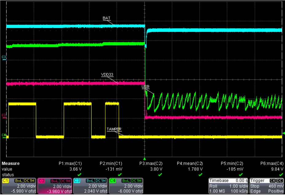

We are using the STM32U585 in a PCI security application and have encountered a question regarding the VDD fall-time specification during an abnormal power failure scenario.
Test Scenario
We are performing a security certification test similar to an "Operation Voltage Extreme High/Low Test".
An overvoltage is intentionally injected at the USB power input to create a system fault condition and verify:
  • Secure data protection functionality
  • Active Tamper functionality
  • Security behavior during abnormal power events
Observed Behavior
When the input voltage reaches approximately 11V, the front-end power IC fails and VDD33 becomes effectively shorted to GND.
The measured power-down waveform shows:
  • VDD33 collapsing rapidly
  • VBAT also exhibiting a noticeable voltage drop
  • Measured VDD fall-time rate ≈ 2.6 µs/V
According to the STM32U585 datasheet, the VDD fall-time rate specification appears to require a slower ramp-down condition.

  2. Why would VBAT also drop when VDD suddenly collapses?
    We would like to understand whether:
    • Internal protection structures could create a temporary current path between VDD and VBAT domains.
    • Backup domain circuitry may draw abnormal current during such a failure event.
    • This behavior is expected under catastrophic VDD failure conditions.
