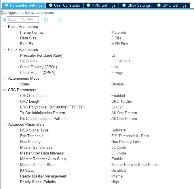

You can found bellow the SPI configuration set on CubeMx

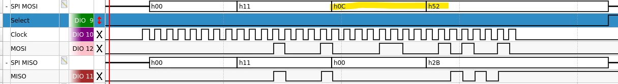

Here is the message read back on my logic analyser, in yellow (0x0C52) you'll found the CRC computed by the uC.
However with the configuration set I am expecting to get this value: 0xE1F0

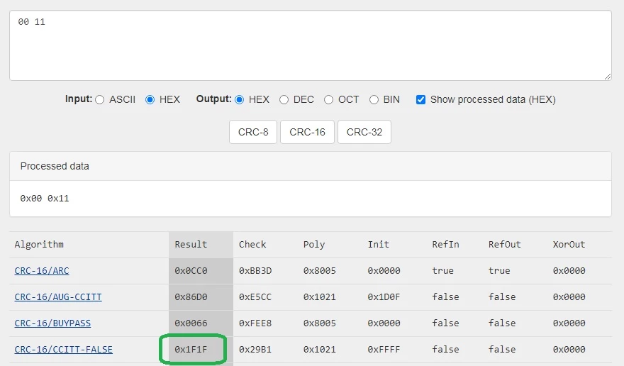

From then I suggest that my CRC SPI configuration was not set properly and from an online CRC calculator (https://crccalc.com/) I have check if I could found a match with an another algorithm, unfortunatly I have made no match.

A quick C coding got me 0x1F1F, so no idea where you pulled any of your numbers or expectations.
An for extra entertainment, I ran it thru crccalc.com

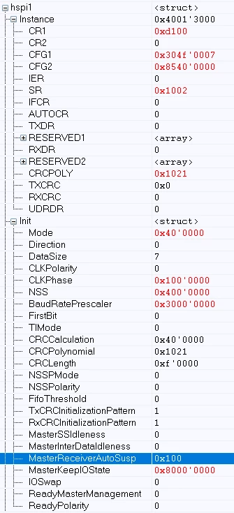

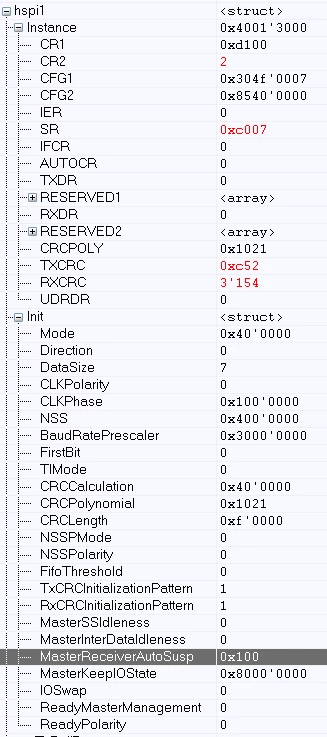

Concerning the SPI register this is the register before the transmission
and bellow the SPI register right after the transmission

I haven't dug into the U5 that deep, but the OP's screen shot shows "Tx Crc Initialization - All One Pattern"
Going to need to walk the transfer and peripheral state one byte at a time to confirm operation and expectations.

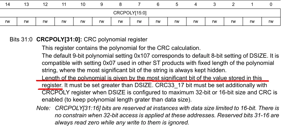

Okay, the 'U5 SPI is yet again more complicated, and the documentation is... well... "ST-style". I faintly recall @Uwe Bonnes writing about it recently. And okay, I see, while there's no way to set an arbitrary initialization value, there's a new TCRCINI bit which allows to set the "all ones" as alternative to "all zeros".
And then there's also this:
