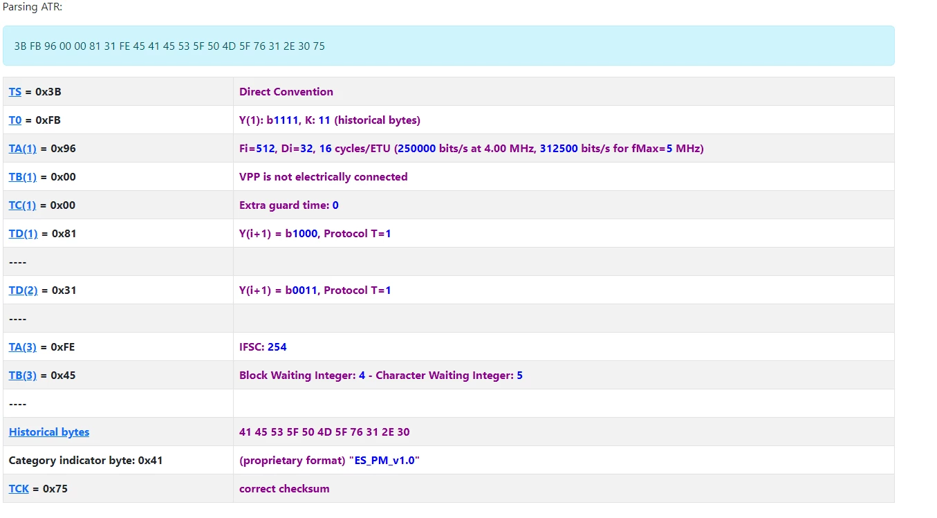

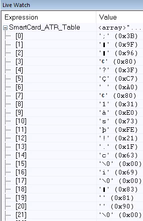

We are testing the STM32U585 Smart Card mode with clock and trying to connect with external SAM module. We are able to get the USART-ISO7816 frame format from the controller but we are unable to capture the ATR value from the module in a correct manner. From the logic analyzer with the setup connected we are getting correct ATR values but inside the controller the ATR values are in the wrong format. Following is the expected card ATR response:
This waveform is obtained from the card reader connected to the STM32U585 board. and the ATR waveform is the correct format as described in the standards. the same signals we are capturing in the STM32U585 debug mode and getting the data as shown in the below figure.

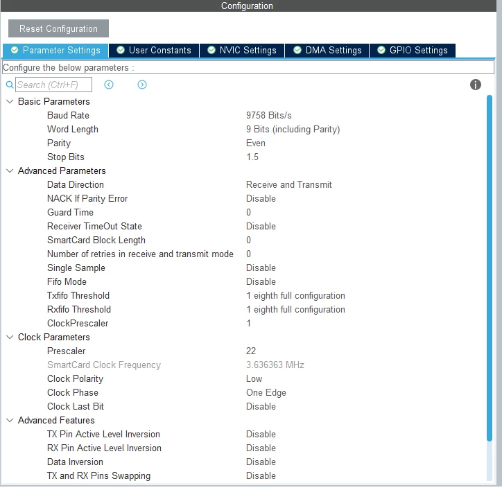

We have used the Smart Card with card clock mode in STM32 side with the following configuration:
 /* USER CODE END USART3_Init 1 */
 hsmartcard3.Instance = USART3;
 hsmartcard3.Init.BaudRate = 9758;
 hsmartcard3.Init.WordLength = SMARTCARD_WORDLENGTH_9B;
 hsmartcard3.Init.StopBits = SMARTCARD_STOPBITS_1_5;
 hsmartcard3.Init.Parity = SMARTCARD_PARITY_EVEN;
 hsmartcard3.Init.Mode = SMARTCARD_MODE_TX_RX;
 hsmartcard3.Init.CLKPolarity = SMARTCARD_POLARITY_LOW;
 hsmartcard3.Init.CLKPhase = SMARTCARD_PHASE_1EDGE;
 hsmartcard3.Init.CLKLastBit = SMARTCARD_LASTBIT_DISABLE;
 hsmartcard3.Init.OneBitSampling = SMARTCARD_ONE_BIT_SAMPLE_DISABLE;
 hsmartcard3.Init.Prescaler = 22;
 hsmartcard3.Init.GuardTime = 0;
 hsmartcard3.Init.NACKEnable = SMARTCARD_NACK_DISABLE;
 hsmartcard3.Init.TimeOutEnable = SMARTCARD_TIMEOUT_DISABLE;
 hsmartcard3.Init.BlockLength = 0;
 hsmartcard3.Init.AutoRetryCount = 0;
 hsmartcard3.Init.ClockPrescaler = SMARTCARD_PRESCALER_DIV1;
 hsmartcard3.AdvancedInit.AdvFeatureInit = SMARTCARD_ADVFEATURE_NO_INIT;

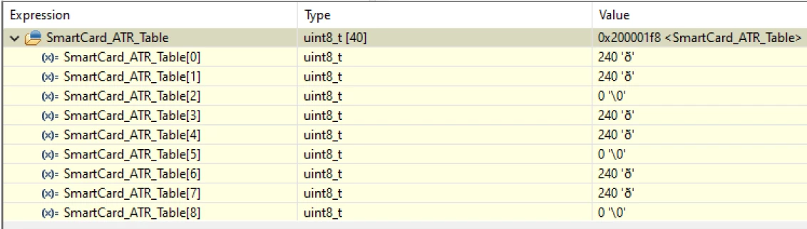

Values in SmartCard_ATR_Table are 240, 240, 0, 240, 240, 0, ... It seems values are 'noise'. The memory was not written and have previous values. How many bytes do you receive?
If this is not the case, maybe baud rate or smartcard clock are wrong. But I believe this is not the case due to the sequence 240, 240, 0.
The logic analyzer is configured with baud rate 9600 or it auto detects the baud rate?

We have tried with 9758 baud rate and 3.75Mhz clock frequency based on the calculation as shown below:
Fi = 372
Di = 1
ETU = 372/1 * (1/3.63x10^6) = 0.00010247 usec
f = 1/T = 1/0.00010247 us = 9758 bits/sec
The Cube MX configuration setup is as shown below:
And the clock supplied for UART3(SmartCard) is 160MHz
Thanks
Pjose

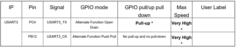

Maybe worth to check configuration of GPIO used for USART3_TX ?
Could it be that reception buffer is filled prior real ATR is sent by the card ?
Just some ideas ...

I wanted to know if you are getting this output by using ST8024 IC. As I have researched there is a 11k internal pullup on IOUC line. So can you please let us know what is the configuration done for the same.
This is my current configuration
Regards,
Guenael Cadier
June 29, 2023
Hi @AdarshTR
GPIO configuration seems ok.
Yes, STM32U575 evaluation board (MB1550) includes a ST8024 between STM32U575 USART IO and card connectors. Schematics of the board could be found here.
