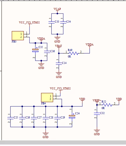

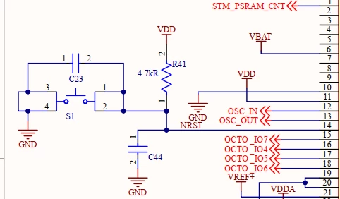

HA2375-Author
Jun 24, 2026 6:43 AM UTC
Hi ​@Ozone ​@Andrew Neil ​@KDJEM.1
Thanks for the Replay
I have attached the schematic related to the power supply and reset section for reference. However, I am still unable to identify the root cause.
What I do not understand is why the MCU does not start properly after a power OFF/ON cycle, but starts and operates normally when I press the NRST pushbutton. Once the pushbutton reset is applied, the application runs without any issues until the next power cycle.

Ozone
Principal
Jun 24, 2026 7:39 AM UTC
> Could anyone please suggest what could cause this behavior? Is there anything specific I should check
> Any suggestions would be greatly appreciated.
I would highly recommend to check the links Andrew Neil provided. Others had a similiar (or same) problem, thus the cause might be the same.
Check the datasheet for power-up requirements (rise times, sequence of different supplies like VDD / VDDA).
I would recommend to measure this on your board with a scope.
And include the NRST pin if you have a scope with asufficent number of channels.

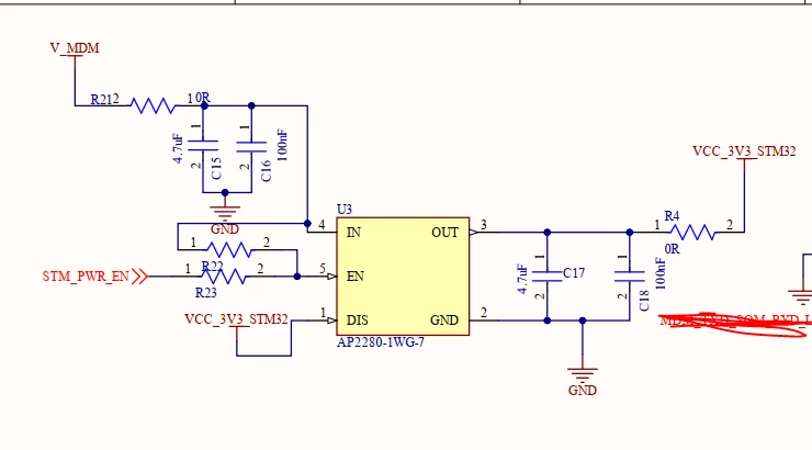

HA2375-Author
Jun 24, 2026 9:17 AM UTC
While investigating this issue, I discovered a schematic mistake related to the PSRAM power switch (AP2280-1WG-7).
The PSRAM power rail is controlled by an AP2280 load switch. However, I mistakenly connected the STM32 3.3-V rail (VCC_3V3_STM32) to the DIS pin of the PSRAM switch instead of connecting the PSRAM output rail (VCC_3V3_PSRAM).
Interestingly, when this incorrect connection is left as-is, the board powers up and operates normally. If I disconnect the PSRAM switch or remove this connection, the STM32 does not start properly after a power cycle and only starts after pressing the NRST pushbutton.
Could this incorrect connection be causing back-powering or affecting the startup sequence? Has anyone encountered a similar issue with AP2280-1WG-7 or STM32U585?
I have attached the schematics of both the STM32 and PSRAM power switches for reference. Any suggestions would be greatly appreciated.
Andrew Neil
Jun 24, 2026 9:32 AM UTC
​@HA2375-
It certainly could!
Again, have you used the debugger to find where, exactly, your code is hanging?
If it’s hanging at the first point where the external memory is required - this may well be your answer!
Maybe try code that doesn’t rely on external memory ...
