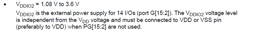

Because port G[15:2] is in VDDIO2 domain that needs to be enabled as stated by @Tesla DeLorean
Please refer to the datasheet DS13737 Rev 10 / page 34.
