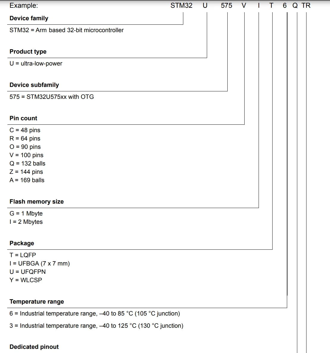

Does the STM32U575CG/I (48-pin package) support USB communication, or is USB functionality only available on higher pin-count variants?
Thank you.
3 replies
Technical Moderator
February 19, 2025
Hi @joaorego
All packages for this family support USB!
575 = STM32U575xx with OTG
To give better visibility on the answered topics, please click on "Best answer" on the reply which solved your issue or answered your question.Best regards,FBL

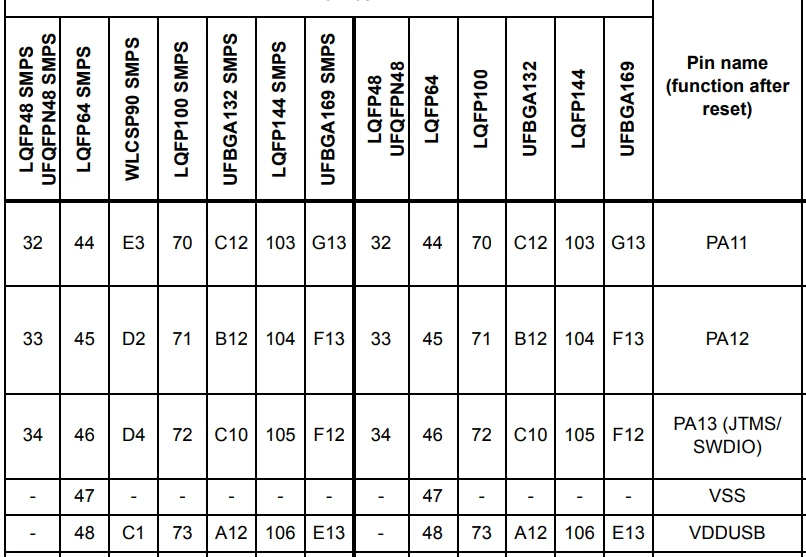

But what about the USB supply voltage? Will it be sourced directly from VDD? Can I still supply VDD with a voltage lower than 3V?
gbm
Lead III
February 19, 2025
USB requires  3.3 V power.
My STM32 stuff on github - compact USB device stack and more: https://github.com/gbm-ii/gbmUSBdevice
Technical Moderator
February 19, 2025
Hi @joaorego
As explained in the footnote of Table 150. OTG_FS characteristics (continued) in page 304,
USB functionality is ensured down to 2.7V, but some USB electrical characteristics are degraded in 2.7 to 3.0 V range.
